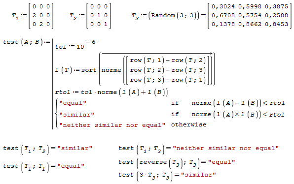

Here's a good task (test) for the SMath fans.
The coordinates of the vertices of two triangles are given.
The program returns three text messages:
1. Triangles are equal
2. Triangles are similar
3. Triangles are neither equal nor similar
#2 Posted: 2023/6/21 06:14:40
1,353 likes in 2,264 posts.
Nice exercise!
ttest_Kr.sm (9.34 KiB) downloaded 1175 time(s).

Thanks!
But can we plot this two triangles?. On Plan or in Space
