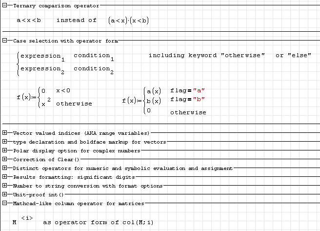

I strongly support both proposals:
- Multiple placeholders would be fine for axis limits and x and y expressions in diagrams (mathcad-like)
- see image for proposals of custom operator formats (from "wish list.sm" in the Activebook).
