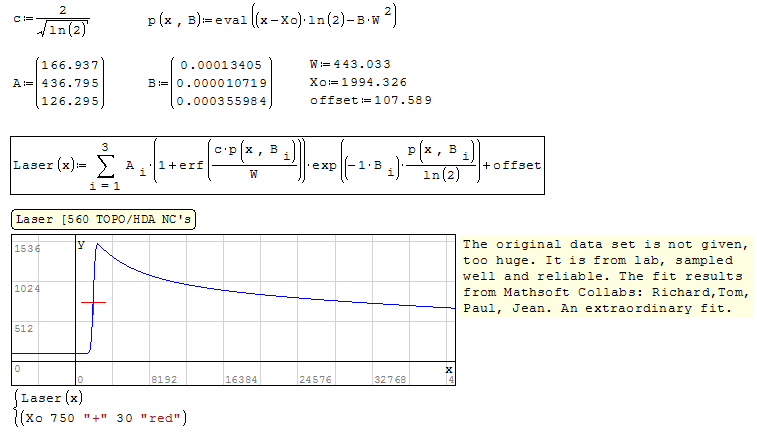

Here, I think the guilty is Smath "erf".
I would prefer be the guilty one.
Any collab is welcome to 'doctor' that one.
Scrap Laser.sm (41.31 KiB)已下载 1276 次。

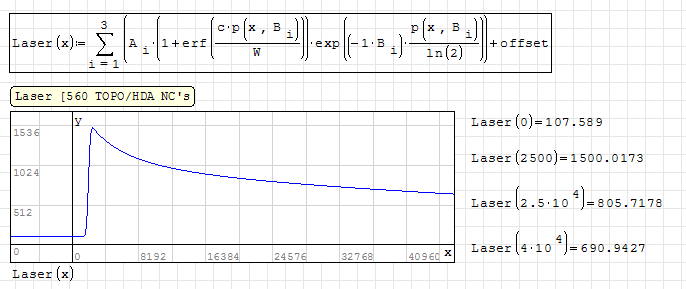

No issues I think,
the guilty is 1+erf()*exp() that should be (1+erf())*exp();
Let me know if there are other issues (erf is part of StatisticalTools)

Thanks Davide,
I just doctored it before reading you. Sorry for my distraction.
