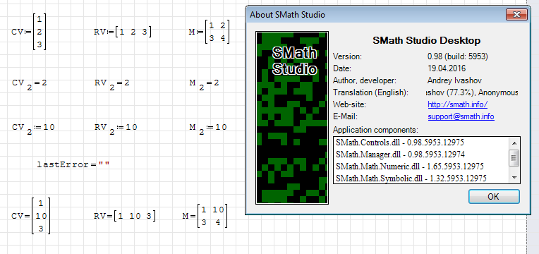

  • Added ability to assign variables/functions put into the vector/matrix;
  • Nice feature
    if possible I suggest to improve the error message when the LHS doesn't fit the RHS (something like "wrong assignment pattern")

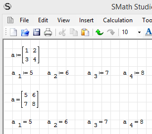

    Andrey,
    a[1 and a[2 do not need the "j" variable. In your screen shot, a[3=a[1,2 in my file and a[4=a[2,2
    I've attached my fileIndex.sm (8.35 KiB)已下载 1688 次。

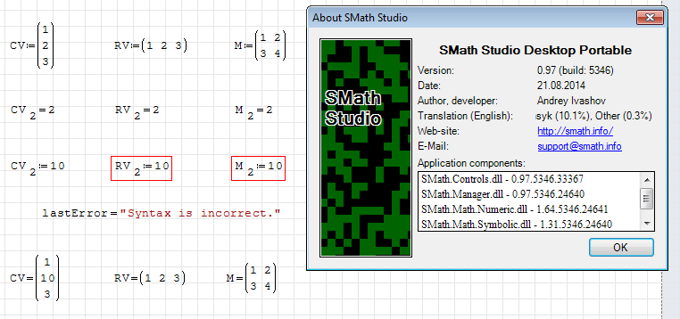

    Linear indexing is a feature to identify an element of a matrix using a single number (base 1 index, starting from the top-left element, proceeding by columns and then by rows]
    [1 2 3 4]
    [5 6 7 8]
    [9 .....]
    Previously it was possible to use el(2) (one-index element) on matrices only in these cases:
    - to set elements in column vectors:
    - to get elements of column vectors;
    - to get elements of row vectors:
    - to get elements of matrices;
    Assigning elements in matrices or row vectors wasn't possible:
    In the meanwhile, a bug was introduced and it was possible to use el(2) in the LHS of assignments for any matrix, but in a wrong way.
    Now it is possible to use this feature to get and set elements of any matrix:
    Andrey Ivashov 2016/4/20 18:35:00

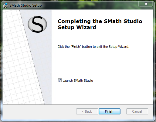

    I have had an install problem with the 0.98.xxxx series versions, installer locks up. I need to go into task manager and kill the install screen after updating or installing fresh at this window.
    If I put my mouse over this box, in Windows 7 (32 and 64), I get the mouse cursor to go to an spinning wheel. Program works fine in all installs otherwise.

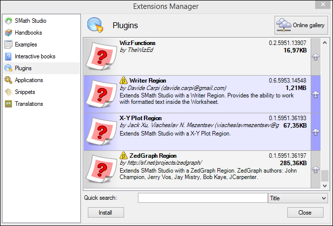

    Mike, I cannot reproduce. I just updated on of my machines to this build. I go into the resulting matrix and the red cross bar "kicks out" into white space. However, on another existing file that was working correctly, it won't open
    You need to open Plugins tab in Extensions Manager, switch to Online Gallery and find & install all available updates there. After SMath Studio restart you will not see this error anymore.
    I'm working on the wizard which will assist users to do this semi-automatically on every SMath Studio update as it is the most common issue now.
    2位用户喜欢此帖子

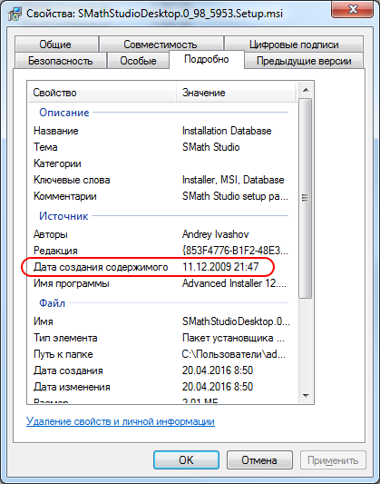

    Why is the content creation date in MSI is shown 11/12/2009?
    Actually, I needed this information when I noticed that this release was released twice: I have been notified by update manager and updated promptly, and haven't been notified again after that, but I started to see files that are "created with a newer SMath version" - 0.98.5953 (the same as mine), but last (fourth) part of version was greater.
    С уважением, Михаил Каганский

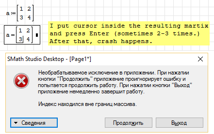

    Spotted matrix definition bug if using Clear():
    未找到文件。未找到文件。
    Also nested definition is not supported? In a form of
    el(el(M,1,1),1,1):5
