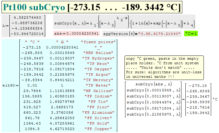

#8 Posted: 2020/11/12 10:30:53
... you can make the unit system silent, i.e: inactive

#11 Posted: 2020/11/14 14:24:48
wrong display of output units
You will have infinitely many of those, easy to doctor:
1. make the system silent, though not quite paper/pencil
2. make it user style at will.
