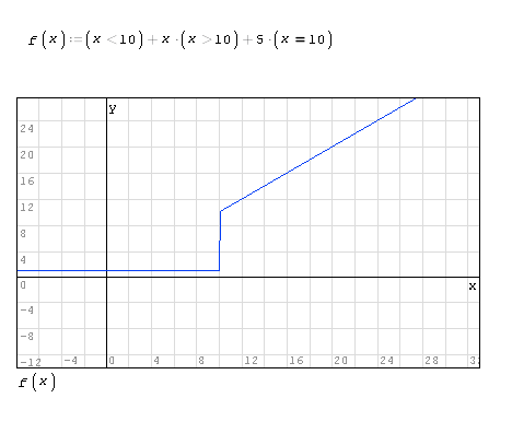

Hello!
I have a problem with simple equation. In case of my function, f(10) is equal to 5 but there is no "dot" of such value on the graph.
Please tell me how it should look like.
Where is the dot.sm (3.2 KiB)已下载 1380 次。

Just point x=10 must be drawn

I think, that it is not proper solution. That "point" is already included in definition of the function, so why I should draw it manually. What in case, if the function is more complex and I don't know that there is such orphaned value in the middle of continous parts of function just from looking on the function definition. Your solution is correct in situation if we exactly know that there is such thing. It should be drawn on the graph somehow automatically, but it's not.

I think the issue is the auto-generated range does not include the point x=10 exactly and therefore never reaches the point where f(x) = 5. Simply allowing for some error as I've done in the attached solves the problem for me. Where is the dot (1).sm (3.85 KiB)已下载 1340 次。
Another option, defining the range discretely.
Where is the dot discrete.sm (5.05 KiB)已下载 1394 次。

From your example it follows, that there is a problem on the level of logical operators - you had to manually insert error what should be done by choosing 'lower' and 'higher' instead of 'lower or equal' and 'higher or eqal'. It looks like, that in such function there is no difference between operators 'lower' and 'higher' vs 'lower or equal' and 'higher or equal'. For me, it should't work this way and it seems to be some kind of 'bug'. At least your idea works as problem workaround, but unfortunately it is still only workaround. Thank you for your answer!

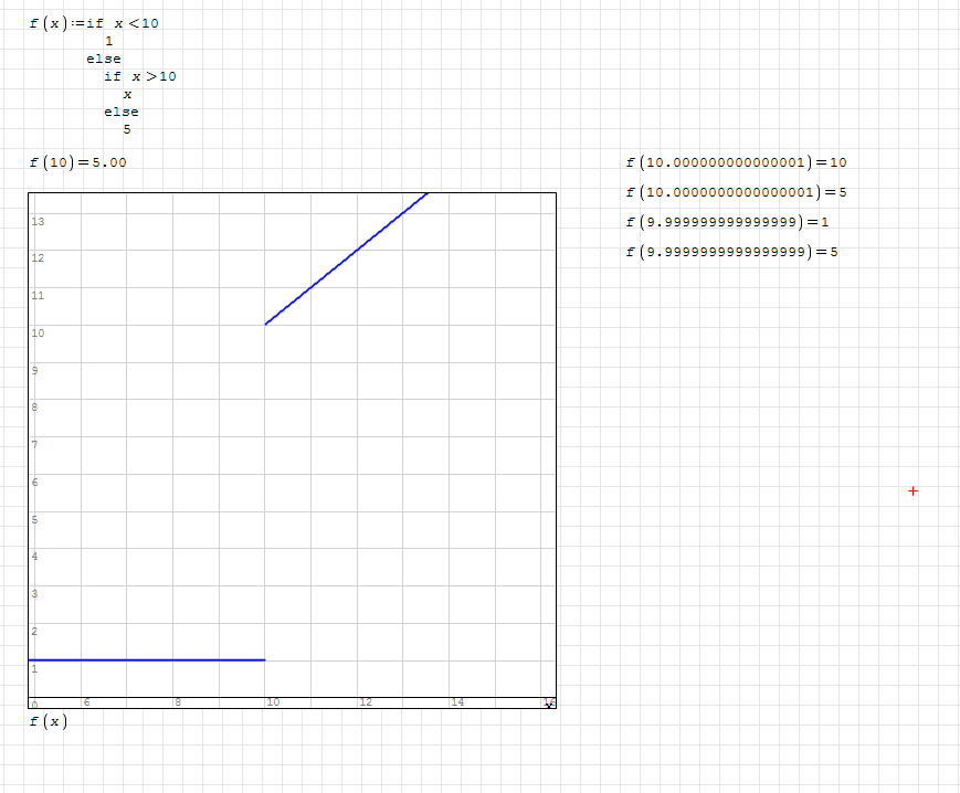

That's part of "the point". The function has to be drawn on the canvas, thus it is calculated for each pixel, and each pixel correspond to a value that depends on the range (first and last values visible), and even on the number of pixels (the width of the canvas).
You can figure it easily placing a breakpoint in the plot placeholder and looking at the values of x.
You must be very lucky to hit exactly 10.000000000000000 (15 digits)

the issue -in my modest opinion - is only on the plot side; your definition of the function and its discontinuity works fine and the value f(10) is evaluated correctly ..but plotting a function with discontinuity requires a discontinuity analyzer i.e. you need ( I mean the developer of the 2d Plot that I guess is Andrey ) to develop a module that find the discontinuities , analyze them and behaves accordingly ( these are at least of 3 different types for functions of one variable ) and this is not so easy to handle.

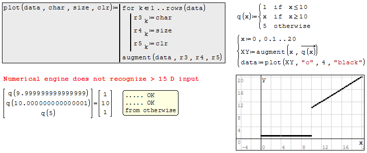

Your setup is not correct. Once in a while, undefined condition(s) do not reflect.
In very rare instances, it's the other way around, i.e: one of the condition must
be undefined wrt the algorithmic suite [typical => De Boor spline point].
Where is the dot discrete.sm (6.82 KiB)已下载 1347 次。

Hi. Yes, you can. With the normal issues for symbolic or numeric manipulations. And as frapuano talk, in some moment we need to implement some code for handle singularities. As an example, maybe too much specific, but about finite jumps, you can see
https://en.smath.info/forum/yaf_postst14910_Round.aspx and the implementation of discontinuous plots in round.sm (69.17 KiB)已下载 1610 次。

Answer @ post # 8. Conditions are either true/false... Not maybe YES/maybe NO.

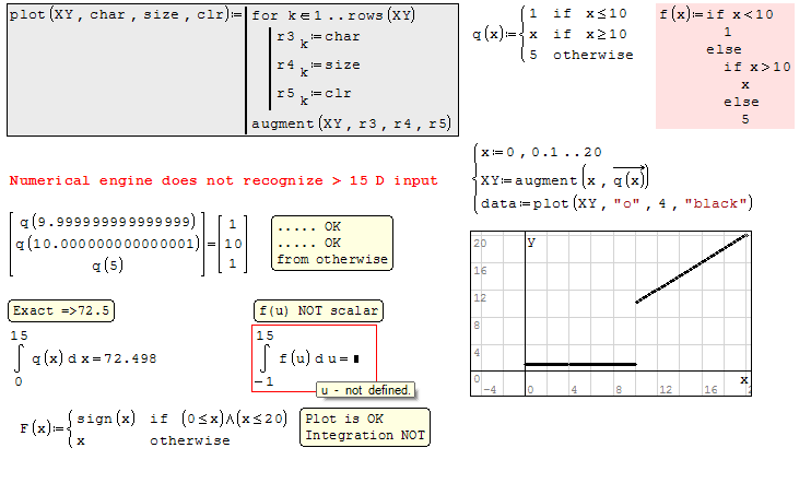

I'm not certain if it's necessary to indicate that a function is intended to be piecewise continous within SMath or if SMath is smart enough to determine intent by the structure of the function itself. I do not think, generally, any function with conditionals can be considered piecewise, but I'm not sure if that's true.
Mon ami, your point is SO fundamental
Those things appeared ad-nauseum in Mathsoft Collaboratory.
Mathcad up to 11, was a bit more understanding, but wrong by principle
because confusing because not telling the truth. A piece-wise function
MUST be specified completely. On that, Smath is absolutely correct.
There are other things under the hood related to this discussion:
Integration of erf(x), and Gamma(x), the integrand must be vectorized.
Indirectly, it kind of depends upon of discontinuous approximation
of these two functions, the only two I have detected.
Most/most important about discontinuous is the major difference between
if/else and if/otherwise. Generally, they do the same but they aren't.
EXPLAIN: if/else is not scalar and it will not integrate a completely
specified if/else function. On the other hand, if/otherwise is scalar
thus will integrate. They both plot the same to add to the confusion.
Demonstrated => Integrate Discontinuous [Nuance].
Demonstrated => Where is the Dot Discrete.
It may even be more important if the path of integration is discontinuous.
Where is the dot discrete.sm (19.27 KiB)已下载 1390 次。
Integrate Discontinuous [Nuance].sm (24.75 KiB)已下载 1206 次。

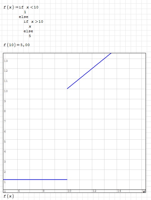

In a more compact form you can view no discontinuities

...It would be interesting to know why it works this way , just for sake of understanding; looks to me that the merging of several OR operations should be linked to this different (... and positive )behaviour.
Franco
They behave the same way; in the first post the plot was made with "Graph by points" enabled.

Strange I had the idea that the graph in the first post was not with "Graph by points" enabled, I am starting to have more issues with my eyes than it was supposed to be.
