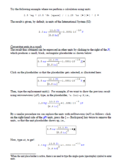

Nmm²:=1 ....... a:= 2, b:=2 .... a+b=4Nmm²
Attached are two typical Engineering projects that don't use unit system.
Standards are given in the appropriate unit system. So, you just need to
append the "UnitResult" accordingly to the formulation.

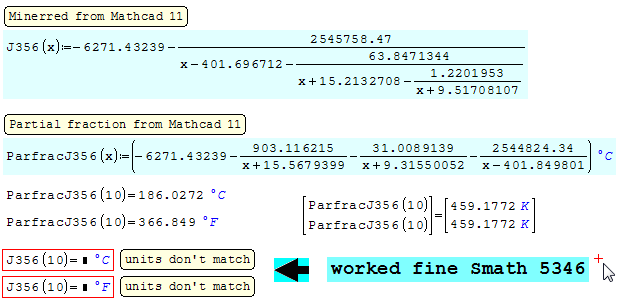

On the other hand, Smath unit system has changed from Smath 5346 to
Smath 6179 ... that freaks many of my projects.
