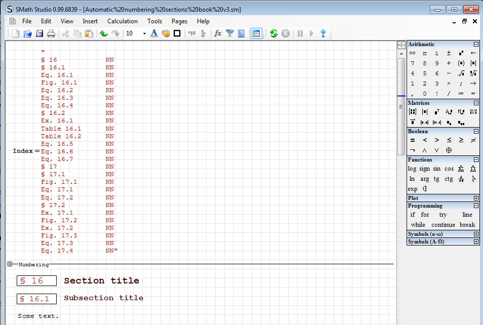

Davide Carpi 2018/10/1 03:25:00
You can display the index at the begin of the document if you assign it to an absolute variable at the end (those variables starting with a tilde ~)
On german keyboards, the tilde has to be copied from a text region as it is catched as a hotkey for boolean = in math regions).
BTW, why don't you use formatted labels?
![2018-10-01 09_58_08-SMath Studio 0.99.6839 - [Automatic%20numbering%20sections%20book%20v3.sm].png](/zh-Hans-CN/files/Download/S7nvyG/2018-10-01-09_58_08-SMath-Studio-0.99.6839---[Automatic%20numbering%20sections%20book%20v3.sm].png)
Automatic%20numbering%20sections%20book%20v3.sm (40.27 KiB)已下载 1650 次。

Hi Martin. Thanks for the update about global variables. I don't use formated labels because I want only to show how get automatic numbering into several SMath documents with native SMath tools. Without any doubt with formated labels it will looks great.
