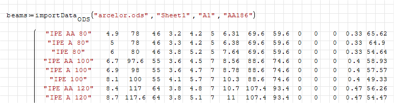

Hello w3b5urf3r,
Hmm...To be honest, I am not quite sure about it. I just used importData(9) and not importData(1). The letter one, importData(1), sometimes reported errors like "The input string was not in a correct format" (not sure why) and I just stick with importData(9). I understood that the 3rd argument is the decimal separator in the text file (txt,csv). I put for the 4th argumnet zero (0) without paying to much attention on it meaning that the default value of function argument separator was used. Not quite sure when the function argument separator ( either "," or ";" ) should be changed and not using the default value.
EDIT: Sorry, I just saw the explanation by Martin
WroteP.S. does anyone know the difference between the 3rd and the 4th arguments of importData(9)?
Wrotearg3 is arg delimiter for symbolic expressions (in case arg9=1), arg4 is column delimiter in the data file.
Davide Carpi 2012/12/18 18:22:00
WroteCSV converted with LibreOffice and imported with DataExchange plugin
Best regards,
w3b5urf3r
Hi w3b5urf3r,
Of course it would be preferable if SMath could handle itself a clean Excel import/export operation.
Seeing that it is not yet the case, I appreciate much your practical solution; I hope it is welcome also for others.
BTW:
I've seen that once the "arcelor" table inputed in SMath, it can be read/write, as it is (with text columns included) or modified, with SMath rfile/wfile.
Once again - Thanks
Best Regards,
Ioan
