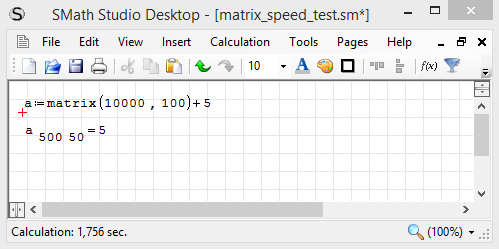

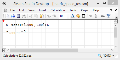

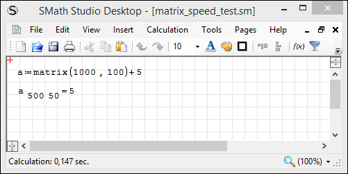

#18 已发布: 2016/2/25 17:59:28
2,344个赞,共4,057个帖子。
组: Super Administrator
Davide, was this ever brought up to Andrey? Matrix manipulation is an important bit for practical use of SMath and right now it is on a slower side.
Thank you for noting this. Just reviewed a code and found possibility to make great improvement to some operations with matrices.
This is latest available public build of SMath Studio (see the calculation time).
This is a new build I've just created locally (changes not related to matrix() function - the overall speed of communication between SS Core and built-in symbolic library improved):
...and even bigger:
Will see if I can found some other places to improve.
4位用户喜欢此帖子
