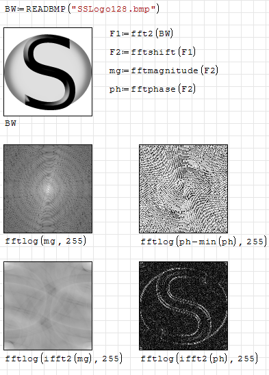

IMHO as it is now processing images on the worksheet is reliable only for small images (only teaching purposes); using plugins you can boost the math speed or build a region that can do all "in-place" but this is not funny because the math is hidden under the hood. A "picture operator" or a boost in matrices management is needed and can be done only by Andrey (here we are focusing on images but the issue may be the same in any signal processing problem, such as audio, wind, etc...).
The example below is ok for a 128x128 image, but too slow for a 256x256 image (or bigger), using greyscale images, and functions driven in plugin: fftmagnitude (abs() extended to matrices), fftphase (arg() extended to matrices), fftlog (basically a logarithm function for matrices); to run all except the ffts in the canvas (in a reasonable time) 128x128 is too big.

I would agree with Davide that it is not the lack of picture operator, but the lack of processing horsepower that makes any sort of image/signal processing impossible in SMath. Right now it takes good 8 seconds just to display a 1000x2000 matrix in the worksheet. And than it lags when you scroll said worksheet as well..
Davide, was this ever brought up to Andrey? Matrix manipulation is an important bit for practical use of SMath and right now it is on a slower side.

Maybe, not yet from my side... about the displaying issues I've made a request in the BTS recently (SS-2291)
You can test performances with this simple function: mlog.sm (3.81 KiB) downloaded 1063 time(s).
Try to change the size of the identity matrix, a 128x128 makes the function sooooooo slow...
