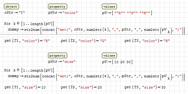

Hi. Something like this?
obj_set_get.sm (11.63 KiB)已下载 1425 次。
2位用户喜欢此帖子
sergio 2023/1/19 07:18:00, Mark R Harris 2023/1/20 04:09:00

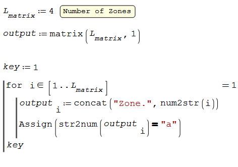

I was testing out your methods with the inclusion of loops and it seems that I can't create a variable beforehand and assign it, it has to be empty. Do you know a way around this?
This is ultimately what I am trying to do with these functions, where I can get a mutable array of "Zones", each with their own properties (ie. area, x/y location etc.)
For reference I read through this thread as well: https://en.smath.com/forum/yaf_postst23278_String-to-Variable-Name--str2var.aspx
and tried some of the solutions posted on there but to no avail.

I figured it out, just don't know a way around it. Since I'm calling str2num(output_i), it's giving me the value of that expression and not the variable itself.
#6 已发布: 2023/1/19 17:22:47
1,139个赞,共1,805个帖子。
Yep. You need to call str2num at the worksheet level. Something like this
obj_set_get.sm (18.86 KiB)已下载 1345 次。
Also, I'm go to modify the code for accept set or collections.
