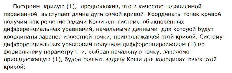

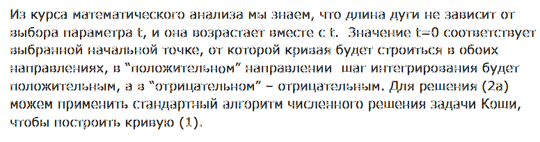

A lot. For instance, from the paper that you give as reference ( https://vk.com/doc242471809_437831729 ) can read:
"From the course of mathematical analysis, we know that the length of the arc does not depend on the choice of the parameter t, and it increases with t. The value t = 0 corresponds to the selected starting point, from which the curve will be constructed in both directions, in the “positive” direction the integration step will be positive, and in the “negative” direction - negative. To solve (2a), we can apply the standard algorithm for the numerical solution of the Cauchy problem to construct the curve (1)."
"We construct the curve (1), assuming that the length of the arc of the curve itself is the independent variable. The coordinates of the points of the curve will be obtained as a solution to the Cauchy problem for a system of ordinary differential equations, the initial data for which will be the coordinates of the previously known point belonging to this curve"
But the final parametrization isn't along the arc length.

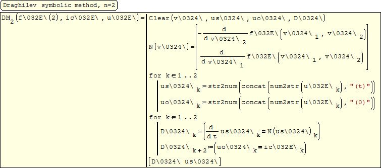

Hi Jean. What you see is the unicode code for some ornaments. I use them because I don't like the use of x#, y# ... etc for each variable in the definition and body of the SMath procedures.
Maybe you don't have the unicode version of Courier New font.
#24 已发布: 2018/10/22 19:00:26
1,443个赞,共2,936个帖子。
Special characters mode is available since Version 0.99.6617, hence can't be rendered correctly in Jean's 0.98.6179 (no matter what fonts he has)
Please note that decorations aren't really needed since 0.98.6325 when Clear() was made built-in and that is enough to isolate line() procedures from external variables (useful in Jean's 0.98.6179, though)
What is the meaning of your messages? Using the arc length as an independent variable is a well-known technique and is not directly related to the Draghilev method, but can be used in the implementation of the method. For example, I widely use this technique. This is achieved by simple normalization of the variable of integration by the magnitude (dx^2 + dy^2 + dz^2)^0.5, in the case of 3d.
Yes, I hope you understand that the curve itself is always unambiguous?

Razonar.
"We construct the curve (1), предположив=suggesting (not assuming) that the length of the arc of the curve itself is the independent variable. The coordinates of the points of the curve will be obtained as a solution to the Cauchy problem for a system of ordinary differential equations, the initial data for which will be the coordinates of the previously known point belonging to this curve"
By the way, where did you find the "parameterization" in the description?
“But the final parametrization isn't along the arc length.”
I do not have and do not use SMath.
Both the circumference and the length of any closed smooth curve can be constructed either by any part, or by any repetitions, giving the coordinates of points a unique dependence on the arc length. The coordinates of the points are functions of the arc length.
Guys, everything works by fundamentals of elementary mathematics and works in areas that were very complex before the advent of the Draghilev method.
Good luck to you in understanding and mastering the Method.

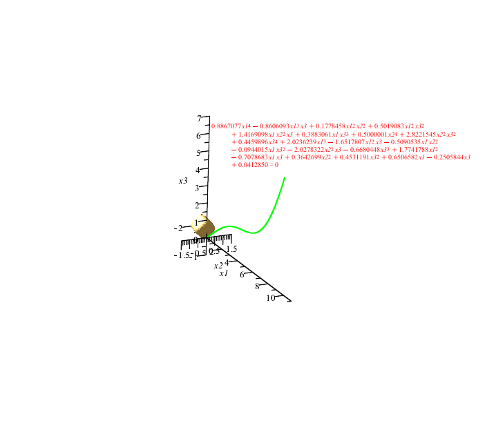

For example, Method Draghilev, however:

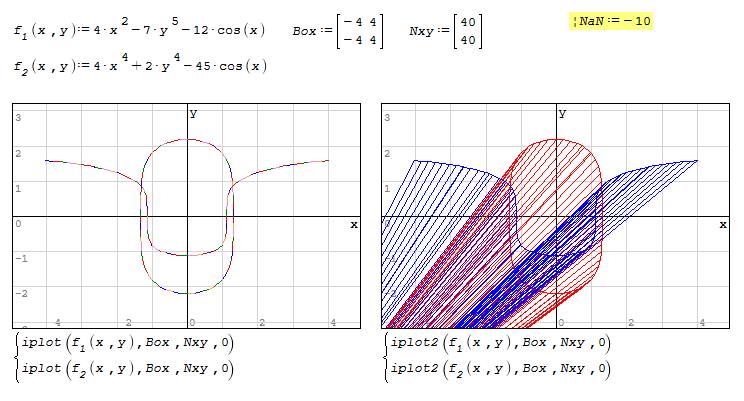

If you find some volunteers to code Tom G. Mathcad contour ... please feel free.
Hi Jean. Problem for code in SMath this procedure it's about that NaN is unavaible in SMath. Here you can see what happens without NaN, and a workaround of that:
https://en.smath.info/forum/yaf_postst12539_Implicit-Plot.aspx
iplotq.sm (40.7 KiB)已下载 1840 次。
The iplot routine is from uni works in mathdcad.

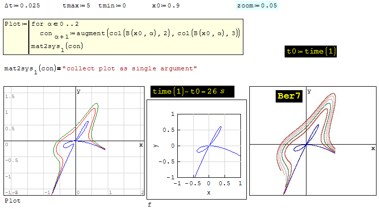

Dragilev method for equations with a parameter.Equations borrowed from Jean Giraud .
JeanContour1.sm (11.52 KiB)已下载 1676 次。
Jean.sm (11.18 KiB)已下载 1648 次。

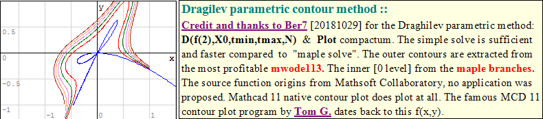

983个赞,共6,866个帖子。
Thanks Ber7 ... Electron function works fine.
Loop function fails, Maple SS 6179 seems in cause [RootOf].
Tried to doctor, not to avail , Ah !
#34 已发布: 2018/10/29 18:51:50
983个赞,共6,866个帖子。
... doctored: few cut/paste has like re-installed the codes,
Can't get the complete loop as yours, but pleased with other contours.
Thanks again ... gorgeous Draghilev/Ber7

Jean, try without a maple.
Jeansolve.sm (11.06 KiB)已下载 1673 次。
#36 已发布: 2018/10/31 21:43:58
983个赞,共6,866个帖子。
It works fine but can't nicely complete the 0 level loop.
It can be done otherwise for the interest of exporting.
This LaceLoop origin from Mathsoft Collaboratory... why ?
Mathcad 11 contour plot does nothing except absolute scrap.
So intriguing, that Tom G. made his own superb contour program.
Draghilev's Contour_2 Ber7 [Loop NO maple].sm (85.14 KiB)已下载 1552 次。
Draghilev's Contour_2 Ber7 [Loop Reconciliation].sm (86.72 KiB)已下载 1572 次。

Point chart. You can see that the distance between the points is the same(Version 0.99.6839)
Version 0.99.6839.sm (11.35 KiB)已下载 1680 次。
#38 已发布: 2018/11/2 13:53:33
983个赞,共6,866个帖子。
Thanks Ber7 for the Draghilev parametric method.
I'm in peace with myself from the attached reconciliation.
Bigger image in the document.
Draghilev's Contour_2 Ber7 [Loop Reconciliation] Copy.sm (152.47 KiB)已下载 1572 次。
