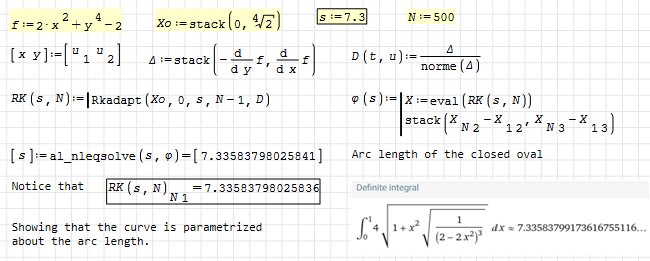

Arc length is about 7.335. I changed N is your sm file to 121 points for smooth curves. rkfixed is a reliable basic method, the other methods are needed for optimization or experimentation or have specific uses.

Hi grelkin2
Arc length is about 7.335. ...
This is how Dragilev's method can be used to calculate the arc length of a closed curve numerically. My improvement on Dragilev's method consists in dividing the system of differential equations by its norm to obtain the parameterization of the curves along their arc length. I have not seen this observation anywhere else.
Arc length of a planar closed curve - Dragilev Method.sm (29.44 KiB)已下载 2020 次。
... I changed N is your sm file to 121 points for smooth curves. rkfixed is a reliable basic method, the other methods are needed for optimization or experimentation or have specific uses. ...

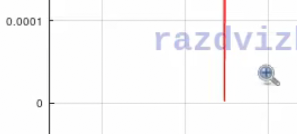

Yes, like my approach with 31 points, except that your zero is more zero than mine, which is only an approximation, but a pretty good one, because to detect it you have to zoom in on the graph. There is no numerical method that can withstand a sufficiently large zoom on its graph. It looks like you use more than 3000 points, something SMath couldn't handle in this case. One question: what's the interpration of the values of the x-axis?
You could have sufficiently large zoom in octave.
olv2.mov (161.87 KiB)已下载 480 次。
Value of the x-axis is the number of points at a given accuracy. I changed the accuracy and, accordingly, the number and combined everything in one animation.
olv3.mov (365.73 KiB)已下载 473 次。
If 1000x is enough zoom for you, and make this point zero, it is ok for me too.

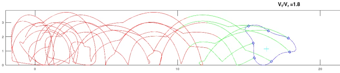

[RUS]В этих замечательных анимациях можно наблюдать движение замкнутых кривых трех видов в зависимости от соотношения скорости движения центра и скорости вращения в точке касания. Движение с пробуксовкой, движение без проскальзывания и движение с проскальзыванием получаются при скорости движения центра меньше скорости вращения в точке касания, равно и больше соотвественно. Владея методом Драгилева можно задавать любой закон движения.
Ниже анимация с ускорением скорости движения, при которой можно наблюдать плавный переход между тремя видами движения, описываемых раннее. Также в эту анимацию включил движение без проскальзывания с циклоидоподобными кривыми.[/RUS]
[ENG]In these wonderful animations, you can observe the movement of closed curves of three types, depending on the ratio of the speed of movement of the center and the speed of rotation at the point of contact. Movement with stalling, movement without slippage and movement with slippage are obtained when the speed of movement of the center is less than the speed of rotation at the point of contact, equally and more respectively. Using the Draghilev method, you can set any law of motion.
Below is an animation with an acceleration of the speed of movement, at which you can observe a smooth transition between the three types of movement described earlier. Also included in this animation is a non-slip motion with cycloid-like curves.[/ENG]
olvm.mov (1.21 MiB)已下载 542 次。
Andrey Ivashov 2025/4/11 04:10:13

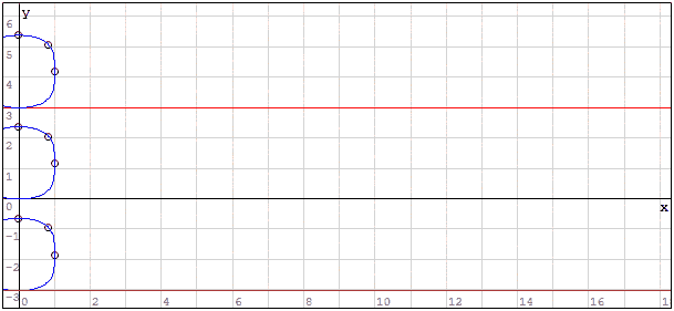

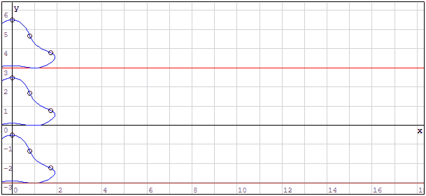

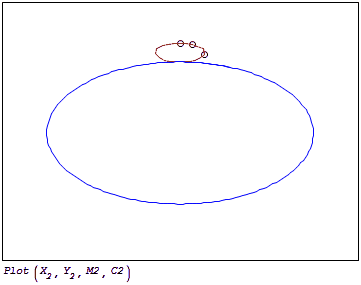

Yesterday I asked the author of one publication, which mentioned the use of the Method when constructing graphs in Mathcad, to write and publish a scientific paper in a peer-reviewed journal.
1
1`
2
2`

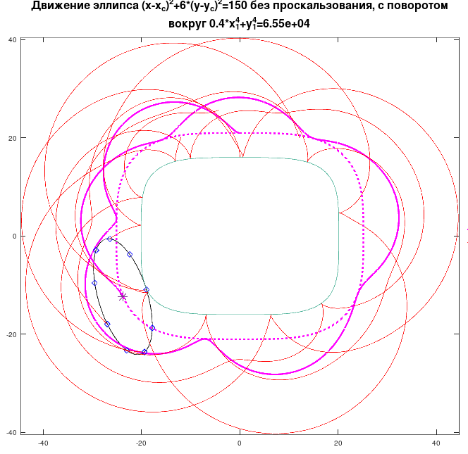

[RUS]Движение эллипса без проскальзывания с поворотом относительно заданной кривой. Улучшенная способ расчета движения точек эллипса только при помощи системы ду. Видно, что центр эллипса движется по некой кривой, зависимой от эллипса и эквидистанты к неподвижной кривой. При окружности центр бугет двигаться по эквидистанте.[/RUS]
[ENG]Motion of an ellipse without slip with rotation with respect to a given curve. An improved way of calculating the motion of the points of an ellipse using the de system only. It can be seen that the center of the ellipse moves along some curve dependent on the ellipse and equidistant to the fixed curve. For a circle, the center of the ellipse moves along the equidistance.[/ENG]
elnkr.mov (811.8 KiB)已下载 484 次。

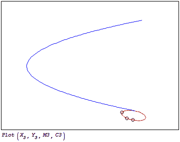

Rolling of a paraboloid clone in its own image.
Directly the picture.
Picture with equations.

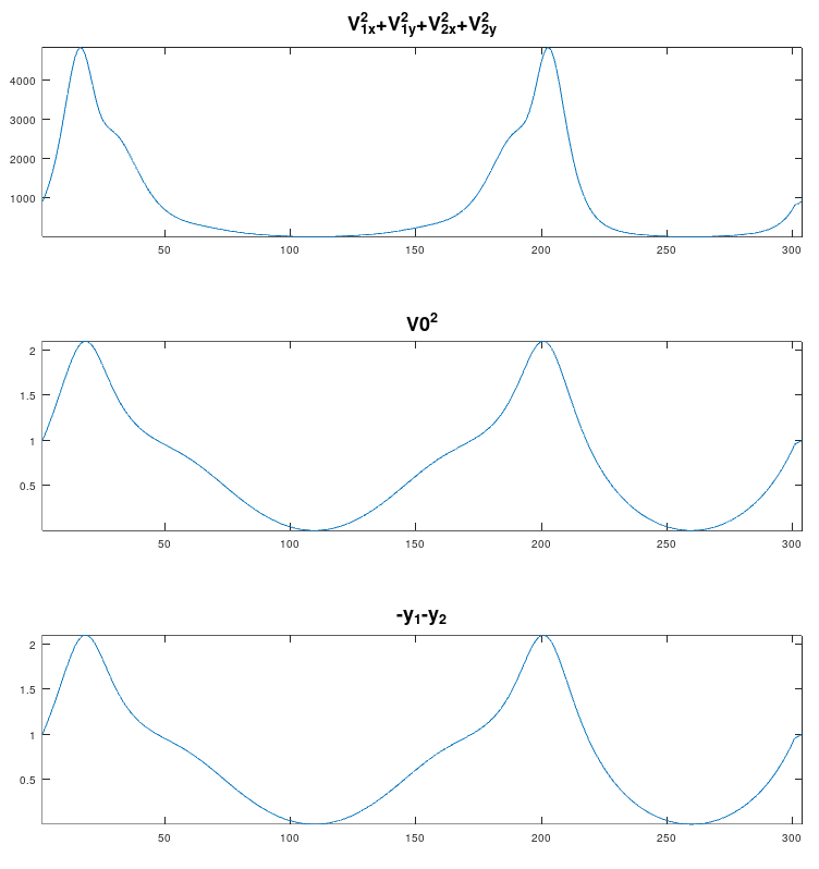

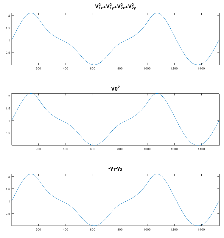

[RUS]Добавим условие, связывающее y1, y2 и новую переменную V0. Получаем новую систему:[/RUS]
[ENG]Let's add a condition linking y1, y2, and a new variable V0. We get a new system:[/ENG]
x1^2+y1^2-1=0
(x1-x2)^2+(y1-y2)^2-2=0
x1*x2-y1*y2=0
y1+y2+V0^2=0
[RUS]Очевидно, что для введенной координаты V0 не выполняется соотношение V0^2=V1x^2+V1y^2+V2x^2+V2y^2. Ниже я привожу графики суммы квадратов скоростей точек 1,2 полученных численно, последнее уравнение делю на две части, которые равны друг другу[/RUS]
[ENG]It is obvious that for the entered coordinate V0, the relation V0^2=V1x^2+V1y^2+V2x^2+V2y^2 is not satisfied. Below are graphs of the sum of the squares of the velocities of points 1 and 2 obtained numerically. I divide the last equation into two parts that are equal to each other.[/ENG]
[RUS]Если использовать специальную норму и поделить всю правую часть систему ду на эту норму, тогда можно получить тождественные графики. Квадрат введенной переменной будет равен сумме квадратов скоростей точки 1 и 2. Привожу ниже графики и анимацию решения[/RUS]
[ENG]If we use a special norm and divide the entire right side of the system de by this norm, we can obtain identical graphs. The square of the introduced variable will be equal to the sum of the squares of the velocities of points 1 and 2. Below are graphs and an animation of the solution.[/ENG]
sysusn.mp4 (195.36 KiB)已下载 266 次。
