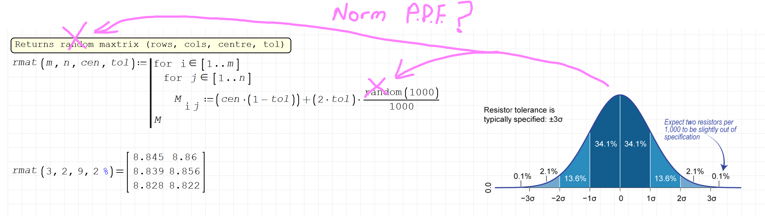

This matrix generator (thanks gUrrozEN) produces random 'equal-probability' values for a given center value and tolerance band.
I'm hoping to revise this to return values within a normal/Gaussian probability as illustrated:
Random to Normal.sm (42.72 KiB)已下载 1319 次。
Any thoughts?

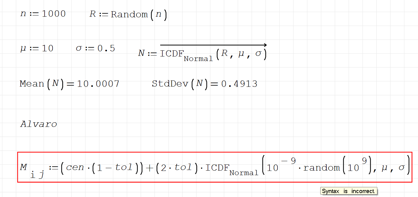

Hi. For 'convert' random uniform distributed numbers between 0 and 1 to another probability distribution, in your case, for get some normal distributed numbers you can use the inverses of the cdf distributions. You can check that here for 1000 numbers you have the desired mean and std deviation
so, I guess that in your function rmat this is the function for normal distributed numbers
random to nomral.sm (5.54 KiB)已下载 1366 次。

For me, the sample file has a problem:
#6 已发布: 2023/1/7 05:55:38
1,139个赞,共1,805个帖子。
Hi. I mean: substitute that M[i,j] into your rmat(...) function for get normal distributed numbers with the rmat algorithm instad uniform distributed ones.
Mark R Harris 2023/1/7 06:22:00

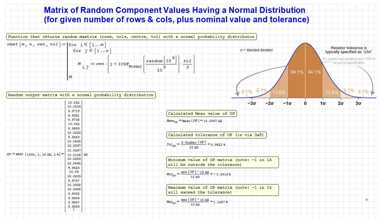

20230109 Random to Normal.sm (54.5 KiB)已下载 1395 次。
