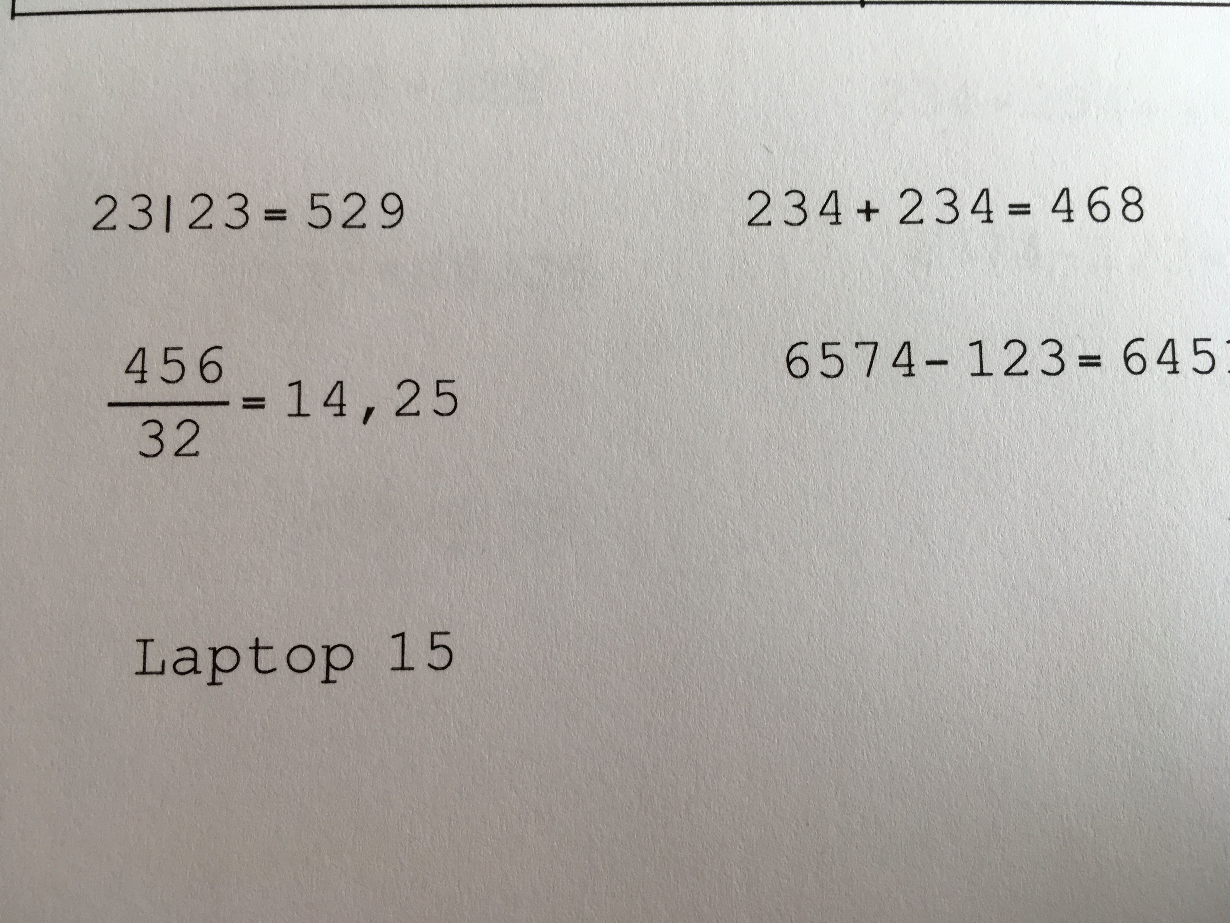

Hello everybody,
when my students print their SMath files it appeares that some of the printouts does not show the arithmetic operator fro multiplication "*" but instead the "|" line instead.
I did install the program from USB-stick, so all laptops have the same version. After install we did not alter any setups. And all Laptops print 2 the same printer. And further are all laptops of the same type/modell including OS (Win10).
Any suggestions, why some prints show the arithmetic operator and others not...?
Kind Greetings
Dirk Oliver Schüler

Sry for the unconvenience, i took a picture!
