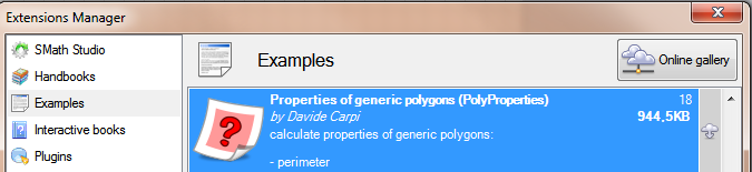

If you are interested, in the Extensions Manager (Tools > Plugins > Examples [Local Storage > Online Gallery]) there is a worksheet dedicated to to polygons' properties - just to not reinvent the wheel
