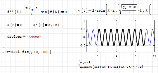

Nevertheless, I do have some questions behind some of the processes you did. Firstly, I believe you changed the sn( 1; 2) function I utilized to a simpler sin() function, I must ask if that was mostly due to simplification of the analytical processes or if there was any other reasoning behind it.
Secondly, you refer that phi(t)' and phi(t)'' have different units and, therefore, H(t) will be incorrect. How could one attempt to resolve that issue?
Thank you very much in advance.
#8 Posted: 2025/2/28 02:06:25
1,106 likes in 1,784 posts.
... Firstly, I believe you changed the sn( 1; 2) function I utilized to a simpler sin() function, I must ask if that was mostly due to simplification of the analytical processes or if there was any other reasoning behind it. ...
Because I don't know how to find the derivative of the arcsin of a complicated Jacobi elliptical si expression. Actually, Wolfram neither. In this version I restored the function sn and the derivatives are found numerically.
... Secondly, you refer that phi(t)' and phi(t)'' have different units and, therefore, H(t) will be incorrect. How could one attempt to resolve that issue?
The way it is written, the units of H do not match. However, I do not know how to fix them because I have no idea what H could be. Is it the Hamiltonian? If you provide some theoretical framework, maybe I can understand a little better what you are trying to solve. Also, there are many unused variables: volume, thickness, beats per minute, diameter...
Numerical and symbolic solution, for what I suppose is the problem to be solved:
Frequency Analysis_v2.sm (189.94 KiB) downloaded 1445 time(s).

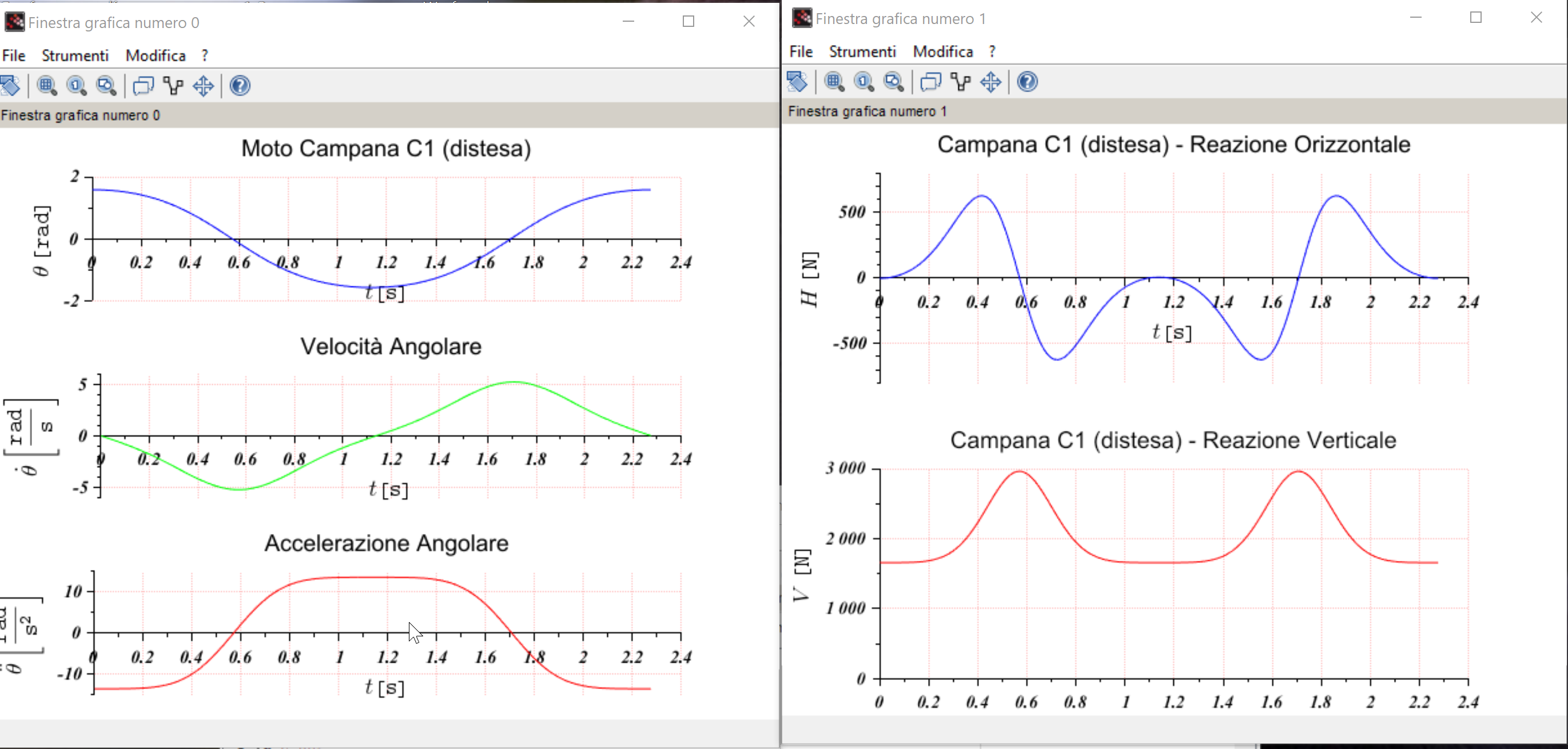

A long time ago I addressed the problem by writing this scilab script that I am attaching, omitting only the part for the production of the graphs. It also works to date. Maybe it can be useful to you, at the moment I don't have time to try to transform it into something Smath

Alvaro, first of all thanks for the great job. I found an important mistake (partly caused by my lightness in the use of the "K" variable). %K is a Scilab function for the calculation of the Jacobi's complete elliptic integral of the first kind (I hope Smath has this function available)

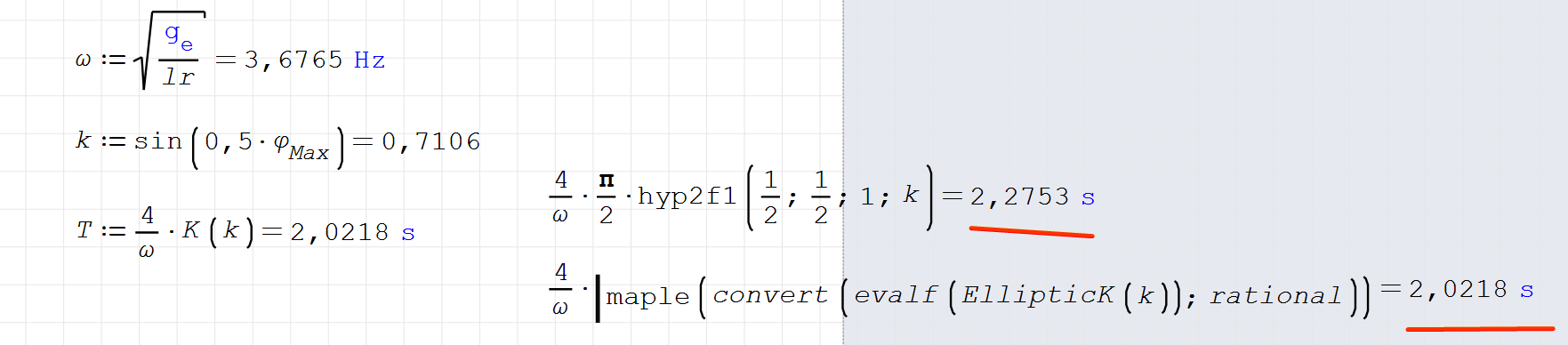

Only a annotation for the calculation of the "K" function: you gave two methods (indicating what you think preferable); The other method numerically provides the same value provided by Scilab and in fact two rather different periods of oscillation are obtained as indicated below (2.02 s against 2.27 s).
I have no mathematical knowledge so high to be able to evaluate this difference that does not seem to me to be of an exclusively numerical type.

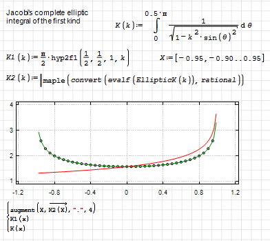

Hi Sergio. You're right. I couldn't find the function among the plugins, so I looked for equivalent ways of writing it on the Wolfram functions site. However, numerical problems with a 4-variable function can be really serious. Surely there is some other, more accurate way, and one that doesn't involve using Maple just to evaluate a function, no matter how special it is.
https://functions.wolfram.com/EllipticIntegrals/EllipticK/26/01/01/
Edited: With this version of K it seems to work fine
Campana di Pompelmo v3.sm (1.02 MiB) downloaded 1431 time(s).
