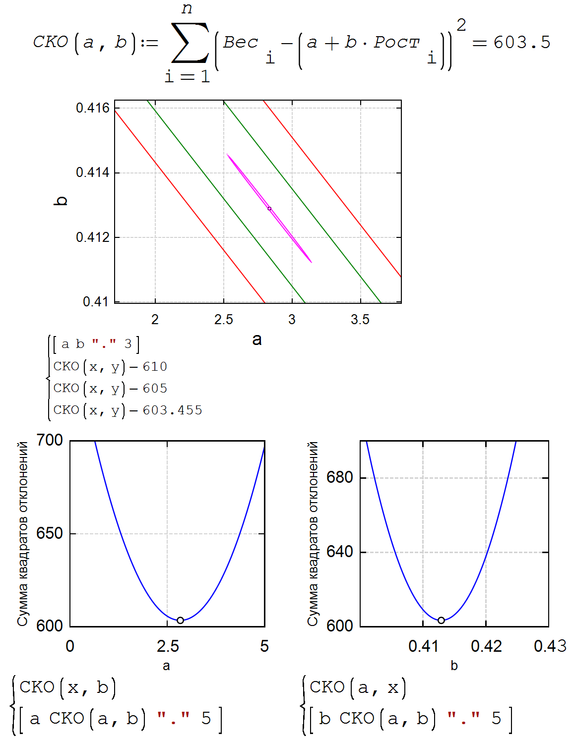

I have two 2D plots, but not one 3D plot with the minimum point.
Help please!

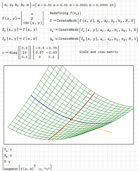

Hi Valery. This is a way.

Hi. Choosing CKO as z and using small ranges.
6-1-Mister-Class 3D.sm (41.91 KiB) downloaded 1084 time(s).
