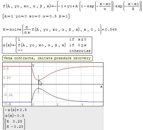

Inst_Colebrook MOODY.sm (19.13 KiB)已下载 1209 次。
Inst_Orifice Plate.sm (387.98 KiB)已下载 1287 次。
Inst_Flow Profile.sm (673.87 KiB)已下载 1330 次。

1. [1975..77] I was involved with the Montreal sewage pumping station, at the time the world
biggest project of the kind, presented to an International Symposium [Yougoslavia].
17 pumps 100000 UGM each, of which two variable speed, 139 ft deep. At the top discharge, 17 Venturi
flow measuring devices, each 8 ft diameter [Brooks ~ 1000000 $ each] Pump engine 4500 HP each.
2. The best beta ratio [Orifice Plate] is around 0.62. Installed in machined meter run and lab tested
give the best accurate mass-flow rate. An industrial plant may have 100's measuring points. It won't
be be practical to have each flow meter associated with its own calibration. Instead we calculate/bore
each orifice plate with its own beta ratio, thus minimizing the burden of the Instrument Men !
No point to purchase expensive Orifice Plate software, Smath does it just perfect.
