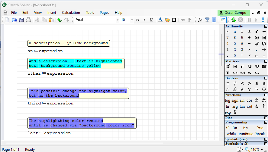

It's not possible change the background color of description region.
Only it's possible change the color which the text is highlighted inside a description region.

600个赞,共1,381个帖子。
This is not persistent. Possibly just a visual bug.
Background color changes to description text is not saved.
I checked with an external text editor, no data saved related to it.
They are same with yellow background and colorful highlighted.
When you save file, close it and reopen it all colors will revert.
Either to latest selected background or yellow.

It is a very strange behavior...
But, before I posted, I did that check you mention. I saved the file, then closed SMath, reopened, and the colors remain...
Close smath, reopen with a blank page, change background color to white, close file without saving.
Now reopen smath with the file you saved, background highlight should be gone.

Yep..
you're right...
it's only a bug
Thanks!!

The feature request is clear, and it is technically feasible, since the text region already has these features.
If you manually edit smath file with a text editor, font size of description can be changed.
However; font color, background color, etc couldn't be altered via this way.
FontSize persists through reopening of file too, if you don't save it again.
Unfortunately when you save it in smath, it removes fontSize attribute from description properties.
So in order to my opinion, these requests are not that hard to be implemented.
