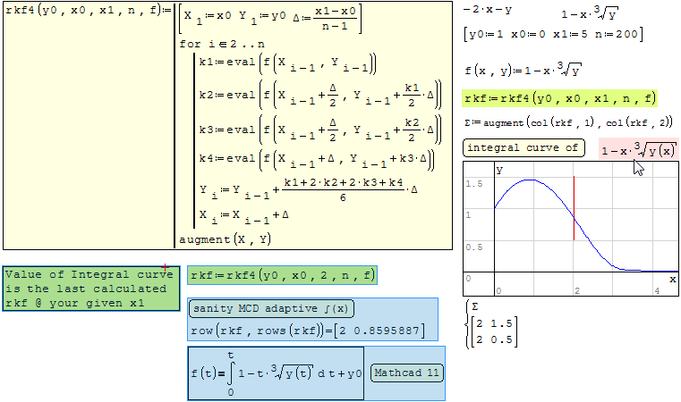

I found no means to integrate that bugger, Ah !
rkf4(y0,x0,x1,n,f) ... does it nicely, very quick.
read more in the attached.
ODE rkf Integrate.sm (24.95 KiB)已下载 1371 次。
