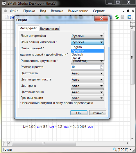

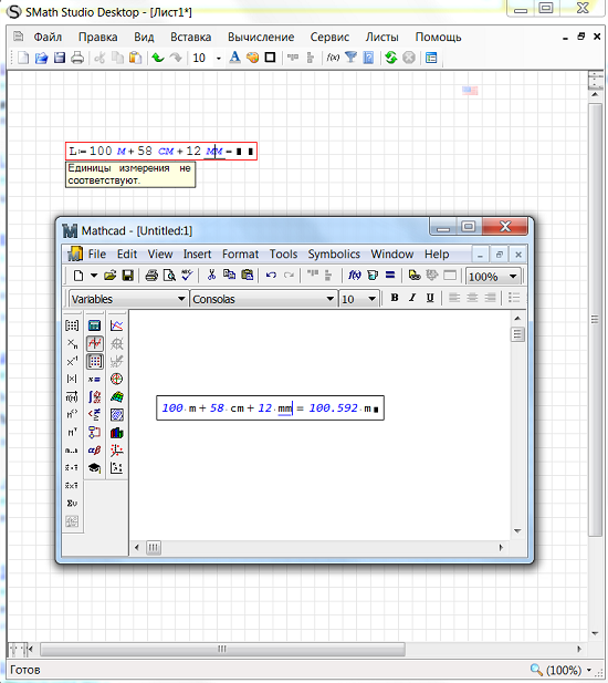

Why this not working?
#2 已发布: 2014/7/11 03:36:24
127个赞,共342个帖子。
because of caps?
[albumimg]354[/albumimg]
#3 已发布: 2014/7/11 03:42:26
1,558个赞,共1,868个帖子。
I use russian units. They do not work. I don't know is this a bug or not. English units are working fine.

#5 已发布: 2014/7/11 04:40:15
1,558个赞,共1,868个帖子。
Thank you Radovan, now it works fine (default was English.).
