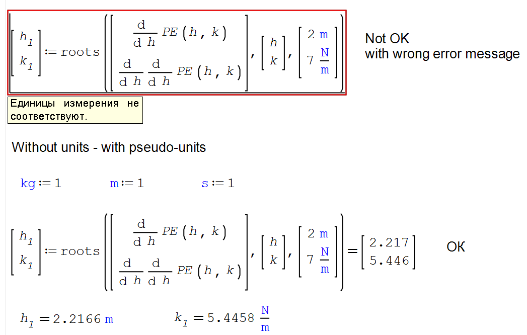

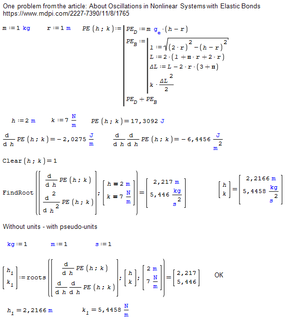

Can Roots and Solve functions work with units?
See please the attach!2-4-OOO-Plots-DD.sm (14.94 KiB) downloaded 1102 time(s).

There are several ways to handle units with SMath roots. This is one of them, where the units are sterilized (Pompelmo' dixit) locally, instead of globally.
2-4-OOO-Plots-DD.sm (12.96 KiB) downloaded 1091 time(s).

Thank you, but this is very difficult for me.
The question was simple: Roots & Units.

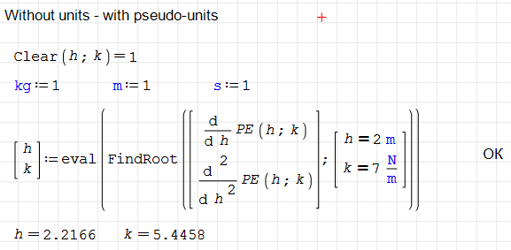

It is simple, if you use Findroot()
2-4-OOO-Plots-DD_Kr.sm (16.37 KiB) downloaded 1096 time(s).

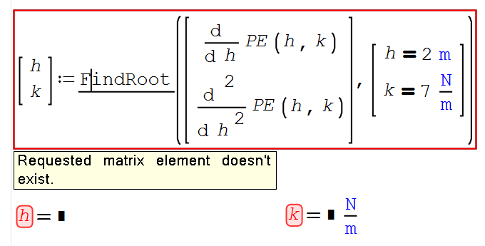

Why?
#9 Posted: 2023/5/20 19:29:49
Why ?... Not coded as per the plugin instruction code.

Use eval(), sometimes it resolves problems.
Especially it is useful on some solver situations.
