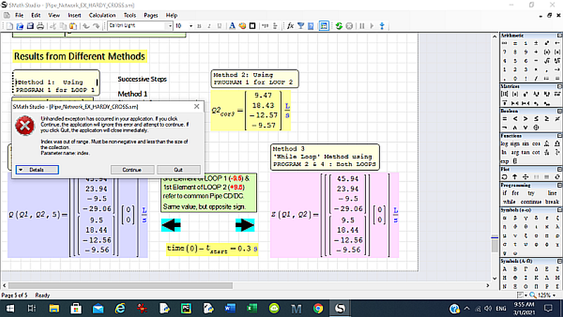

Whenever I try to edit contents of some description boxes the unhandled exception error message props up. For information of Developers please.
#8 Posted: 2021/3/1 07:41:53
1,441 likes in 2,932 posts.
Please attache the content of the "Details" window.
Details Window.txt (30.14 KiB) downloaded 915 time(s).
Pipe_Network_EX_HARDY_CROSS.sm (299.12 KiB) downloaded 1218 time(s).
#10 Posted: 2021/3/4 08:53:47
2,326 likes in 4,013 posts.
Both issues fixed. Thank you!
