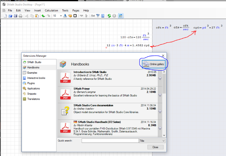

#4 已发布: 2015/12/24 17:02:21
dio pants
dio pants
16个赞,共180个帖子。
did you look at the handbook or links to learn SMath?
-> Tools-> Plugins -> Handbooks
You might want to download some of the online info too.
units- you can always define what you need in a worksheet if you need-
