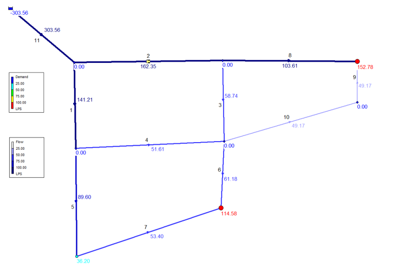

Hello ndtma
I have used Epanet to solve your exercise, by the Hazen Williams method with the following assumptions:
Minimum tank height 66 meters
the roughness of the pipe 120
node height 0 meters
diameter in millimeters
pipe length in meters
khedidja sebkhaoui 2026/1/3 17:52:55

Also, many thanks to Carlos for his example using EPANET which prompted me to check and correct my program.

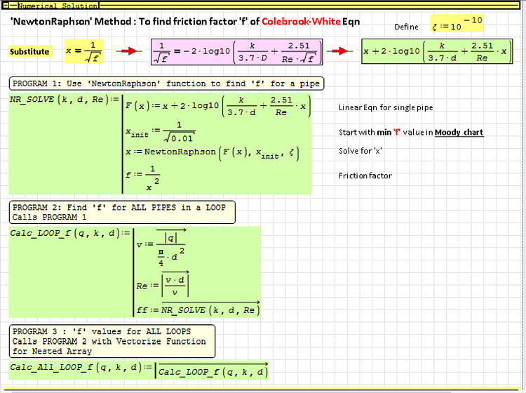

Hardy Cross method revisited.
The friction factor for turbulent flow is calculated using the Colebrook-White equation.
Due to the implicit nature of this equation, calculation of the friction factor requires an iterative solution via numerical methods. Hence, many explicit approximations have been proposed such as Haaland, Moody, Jain etc. to simplify the calculation process.
The attached sm file shows the iterative method of solving the Colebrook-White equation to calculate ONLY the friction factor ‘f’, for use in the Hardy Cross method. The calculated pipe flows were well within the values obtained in my last example.
Cheers.
Colebrook-White-Numerical Soltion.sm (44.21 KiB) downloaded 1192 time(s).
Colebrook-White-Numerical Soltion.pdf (176.14 KiB) downloaded 1010 time(s).
