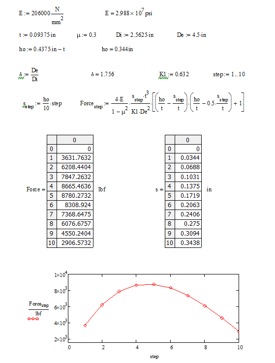

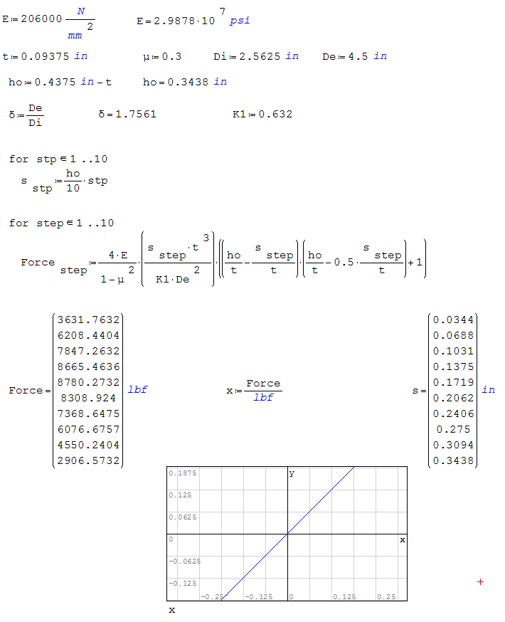

I try to plot a vector of results on a 2D graph to better visulize the results.
I would like to plot the vector values on the Y axis against the vector index on the X axis.
Here I post what I have done in MathCad and what I try in SMath.
issue 1: I need help in defining the plot value for SMath.
issue 2: I also need help in how to define two or more expressions within one for loop.

#2 Posted: 2014/1/21 12:52:41
1,353 likes in 2,264 posts.
Just use x as index.
Use the line() function (programming palette) to set up blocks of expressions.
