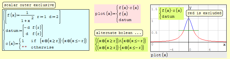

#13 已发布: 2022/7/28 09:03:05
983个赞,共6,866个帖子。
(which was annoying if only if-statement was needed)
IMHO, I have never seen only if as it is not Bolean.
if/else ... if/otherwise are generally not interchangeable.
In program if/else on strictly numeric branching.
if/otherwise is a scalar function for plotting, integrator, solving ...
Cheers ... Jean if you wish more.
#14 已发布: 2022/7/28 11:00:13
983个赞,共6,866个帖子。
Under construction ...
... if/else in program.
... if/otherwise scalar [plot, solve, integration ...]
Good reading ... Jean.
X_Y Bolean EXCLUSIVE...TREASURY.sm (105.5 KiB)已下载 1900 次。
