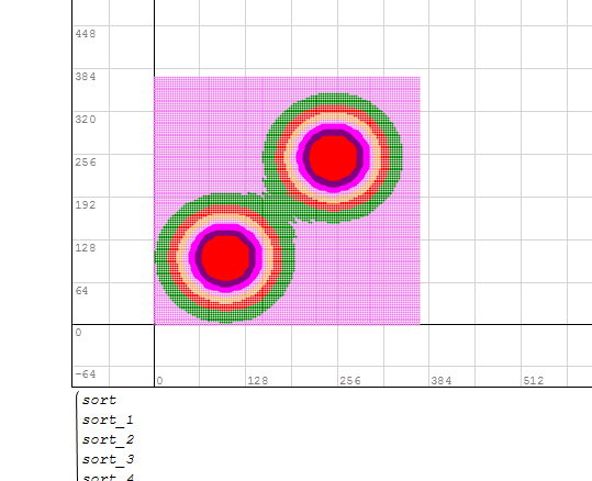

1. You can have as many rings as desired, sizes as well.
2. It may be profitable to transit/spool to file.
3. You may have in any Web colors from otherwise construction ?
4. Rectangle may be added ?
Circle Monte Carlo.sm (24.04 KiB) downloaded 869 time(s).
2 confirmations:
1. Spool to file YES for recovering from other document.
2. Web colors YES from code ... somewhat greedy !
Circle Monte Carlo.sm (32.22 KiB) downloaded 882 time(s).
