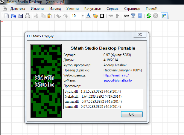

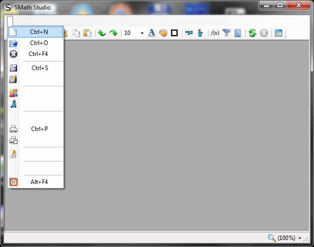

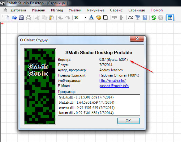

WroteOn the other hand, I have no notification of the changes will have affect after restarting SMath when changing to Srpski or Српски contrary to other languages when I have this notification
Me too I've lost the message box, with any language, after some changes.
The portable distribution is from the previous Nightly Build, have you tried also unpacking the current linux archive? (SMathStudioDesktop.0_97_5301.Mono.tar.gz)
WroteWroteOn the other hand, I have no notification of the changes will have affect after restarting SMath when changing to Srpski or Српски contrary to other languages when I have this notification
Yes, I did. It seems there is no problem with the portable version. On the other hand, I've noticed that at the Desktop (problematic) version my languages are on the top of the list???
WroteOn the other hand, I've noticed that at the Desktop (problematic) version my languages are on the top of the list???
I see, maybe this helps Andrey to understand where is the problem (my desktop build works like your portable build)...
WroteWroteOn the other hand, I've noticed that at the Desktop (problematic) version my languages are on the top of the list???
I hope as well
Looks like it caused because this folder is not empty. I will handle it in next version.

WroteSeems I found a problem. Radovan, please try to delete lang folder from C:\Users\[YOURPROFILE]\AppData\Roaming\SMath\extensions\.
It seems you are right Andrey. The lang folder existed in Desktop extensions folder (guess which two files resisted there
Thank you,
Thank you for your report!
Regards.
