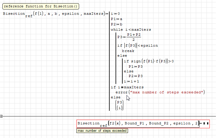

SMath Forum SMath Studio Questions error function use 1 Pages (3 items) error function use - Ioan - Messages Go to last post #1 Posted: 2012/9/8 15:28:45 Ioan 1 likes in 26 posts. Group: User Hi everybody,Please, are there some examples for the use of error function ?Regards,Ioan #2 Posted: 2012/9/8 15:55:07 Davide Carpi 1,441 likes in 2,932 posts. Group: Moderator WroteHi everybody,Please, are there some examples for the use of error function ?Regards,IoanSee the attachment regards,w3b5urf3rEDIT: new wiki page for error added If you like my plugins please consider to support the program buying a license; for personal contributions to me: paypal.me/dcprojects #3 Posted: 2012/9/8 16:06:07 Ioan 1 likes in 26 posts. Group: User Thanks a lot w3b5urf3r,Best regards,Ioan 1 Pages (3 items) New Posts No New Posts
