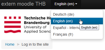

I am being directed to this login page:
https://extmoodle.th-brandenburg.de/login/index.php
#203 已发布: 2017/3/8 05:48:21
Brian Runagle
Brian Runagle
13个赞,共27个帖子。
Thanks for that Alex, that's where I'm being directed too - I thought I was doing something wrong!
Brian
#204 已发布: 2017/3/8 06:04:58
1,443个赞,共2,936个帖子。
You must register before. On the page header you can change the language (BTW I've updated the link on the wiki to access using the english interface)
2017-03-08 10_05_10-Externe Lernplattform TH Brandenburg_ Log in to the site.png
bdrunagle 2017/3/8 06:55:00

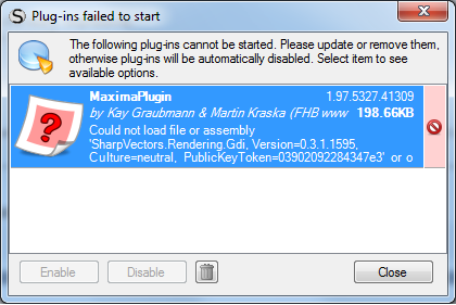

I have installed the regular Windows x64 version 0.98 (build: 6179) and have installed the Maxima Plug-in from the online gallery.
Upon opening SM I get the following warning:
I don't see how to remove or update the plug-in (CoolProps plug-in updated ok).
Maybe I have overlooked a step?
Tim
#210 已发布: 2017/5/18 15:52:35
Brian Runagle
Brian Runagle
13个赞,共27个帖子。
Confirmed for me also with 0.98 6179 and Windows 8 x64.
Brian
#211 已发布: 2017/5/18 18:05:51
983个赞,共6,866个帖子。
Click on "Close", here is Smath eager to run.
Same happened to me after few weeks of running fine
w/o this unexplained error message. It might be enough
to remove from the directory and re-download ?
