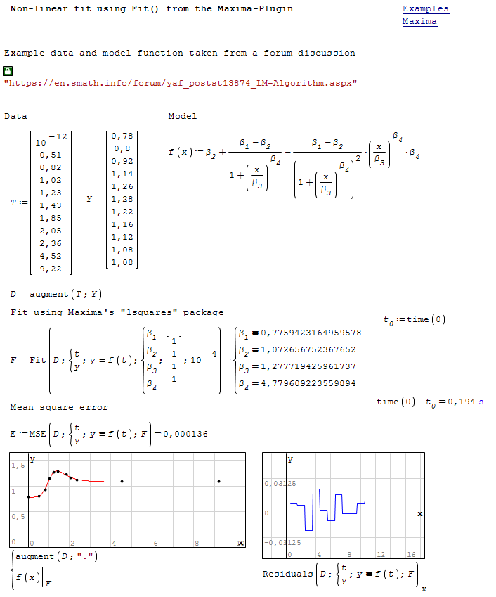

Example application for Fit(), MSE() and Residuals() and efficient plotting.
Example Fit.sm (13.62 KiB)已下载 1701 次。

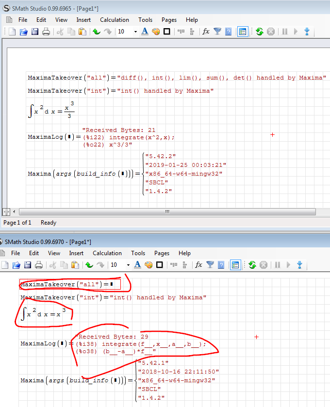

Severe problems since SMath build 6970. Last version tested ok is 6965.
maximaproblem.sm (4.28 KiB)已下载 1698 次。
#254 已发布: 2019/2/26 04:03:40
325个赞和1个踩,共2,052个帖子。
Confirmed, I think...

The problem remained unsolved
However, it seems that Det(),Diff(),Int(),Lim(),Sum() are working well.

Plugin updated. Please try.
2位用户喜欢此帖子
Martin Kraska 2019/3/6 15:41:00, frapuano 2019/3/6 17:28:00
#259 已发布: 2019/3/6 15:14:38
I think it is all right now. Thank you.
#260 已发布: 2019/3/6 15:40:46
1,362个赞,共2,276个帖子。
I confirm that the API issues seem to be resolved. Andrey, thank you very much, I might not have been able to fix that soon.
