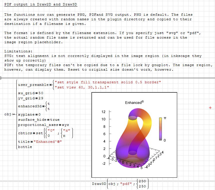

Radovan Omorjan 2017/8/14 03:07:00

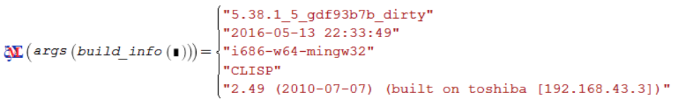

#235 已发布: 2018/2/22 13:10:16
1,362个赞,共2,276个帖子。
please attach your sm file and give the output of Maxima(args(build_info(#)))
#236 已发布: 2018/2/22 13:11:28
1,362个赞,共2,276个帖子。
#237 已发布: 2018/2/22 13:24:03
João Felipe Seráfico Melo
7个赞,共62个帖子。
.sm file: testing_drawing2d.sm (14.53 KiB)已下载 1684 次。

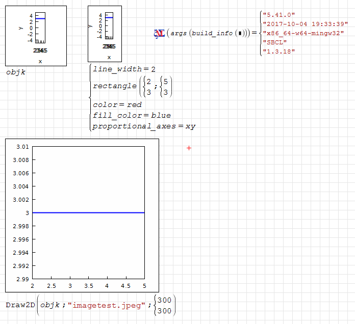

#238 已发布: 2018/2/22 13:33:52
1,362个赞,共2,276个帖子。
Works for me. Not really exciting because the rectangle is just a horizontal line but works.
Your maxima is outdated and not set to steel bank common lisp (SBCL). If you really need to work with old maxima, then you might try the 2014 version of my portable distribution, follow the link in my signature.
