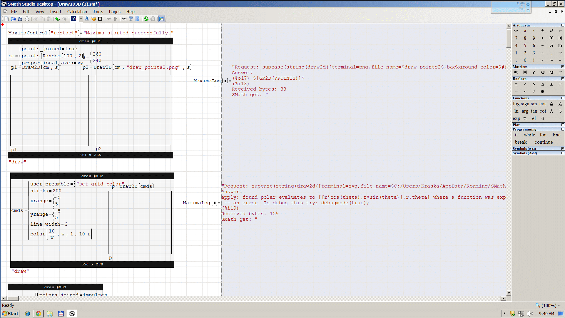

#72 已发布: 2014/2/27 10:52:14
Igor Skarine
Igor Skarine
14个赞,共97个帖子。
Hi Martin,
I'm sending a screenshot for the test, you provided.
#73 已发布: 2014/2/27 14:16:28
1,362个赞,共2,276个帖子。
Hi Igor,
the first two plots shown should in principle work, the third plot shows the same error message as on my system. There is some problem with the function polar() in the interface.
The log message for the second plot looks fine, there should be a file of the name specified in your system. Try to search for it.
Maybe, there is a path issue? Try to add CurrentDirectory(DocumentDirectory(""))= to the sheet. Or try to launch it by clicking the sm file and alternatively, opening the file from a running system. Any differences?

Whatever I try, the result was the same - empty graphics place-holders.
Looks like Maxima can't create picture files on my file system (Win7-64b, administrator).
Igor

#77 已发布: 2014/3/5 15:35:01
1,362个赞,共2,276个帖子。
You need to use Maxima 5.31.1-1. That is the most recent version where the draw package works from within the Maxima plugin. I shall add that hint to the topic starter post and to the interactive book.
