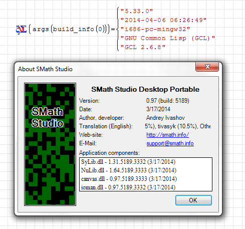

Here is another portable SMath with Maxima.
- unzip the file wherever you want (space requirement 140 MB
- launch the executable in SMath\2014 04 17 SMath 0.97.5189 Portable
You also can run wxMaxima in SMath\Maxima-5.33.0.1\wxMaxima
As a test you might run the attached file. The package contains an experimental version of the Maxima plugin, some of the features (in particular the file format of plot regions) may change.
There are stability issues with the draw functions. They can crash Maxima and sometimes SMath if their input is not defined.
Fit.sm (21.46 KiB)已下载 1676 次。

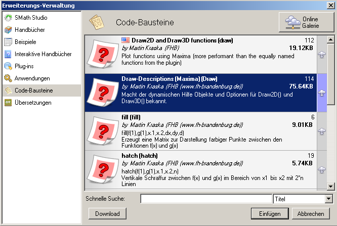

I've uploaded a snippet with descriptions for Maxima Draw2D and Draw3D graphic options and objects. Thus they are known to the dynamic assistant for hints on syntax and for auto-completion.
Shortcut is "Draw"
todo:
- integration of the texts in the Maxima plugin (possibly with config file for adding new texts without re-compilation)
- translation to other language (now mostly german)
- extension to other Maxima functions.
Shortcut is "Draw"
todo:
