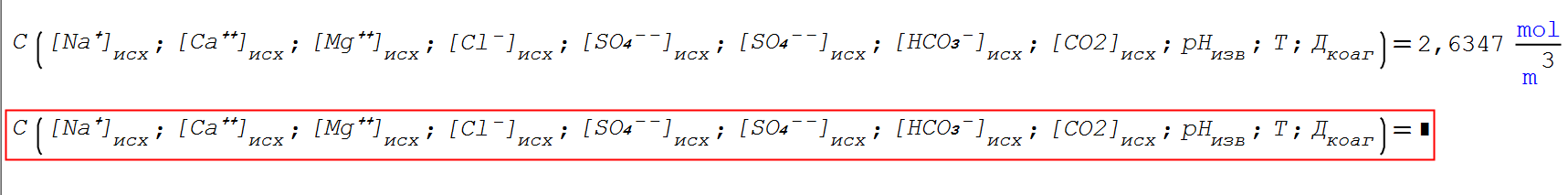

Why we have an error in this SM-sheet
Why we have an error in this SM-sheet - In Mathcad Prime all is OK - Messages

t is undefined. And why do you have [SO₄‾‾].исх as an argument twice?

I have corrected but new error message
Predochistka.sm (59.97 KiB) downloaded 1154 time(s).

I call the function one more and get an error. Why?
Predochistka-Err.sm (62.61 KiB) downloaded 1180 time(s).

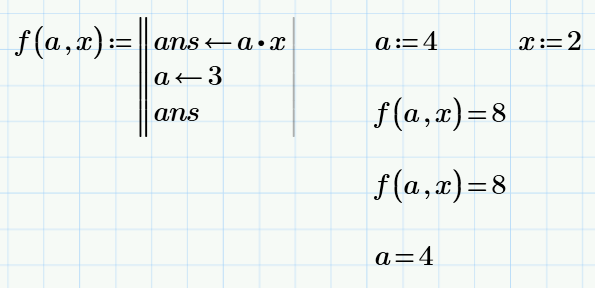

You redefine some function arguments inside the function body. That change its values globally:
See the green area in the document. Also, as an example:
