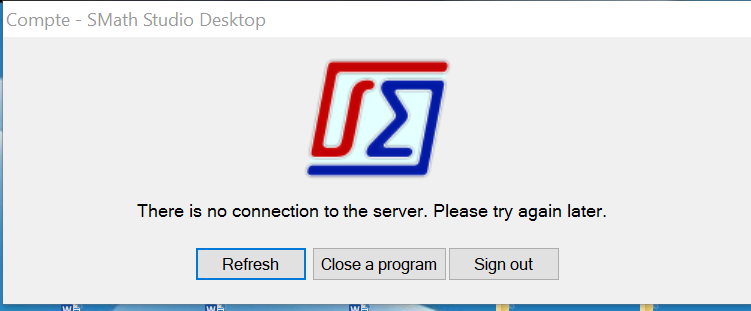

Sometimes I faced a Smath behavior that I do not know how to interpret.
SMath is totally freezed and data are lost. The received message is:
1.I wonder if somebody else met the same problem.
2.I’m interested about the reason for this artifact?
3.I'd like to know if I had done something abnormal and especially I'd like to know how to avoid this;
Thanks for your attention,
Ioan
Whatever the issue with license check is, this shouldn't happen.
When you log in there is a procedure for a offline activation, you might try that to avoid this issue.

Thanks for the advice.
I registrated SMath offline.
Whith this procedure, the admitted registration is valid for max 12 months.
Probably, the procedure has to be repeated each 12 month ? My licence is: lifetime.
Thanks again

That's my interpretation as well (I checked and I have the same options)
