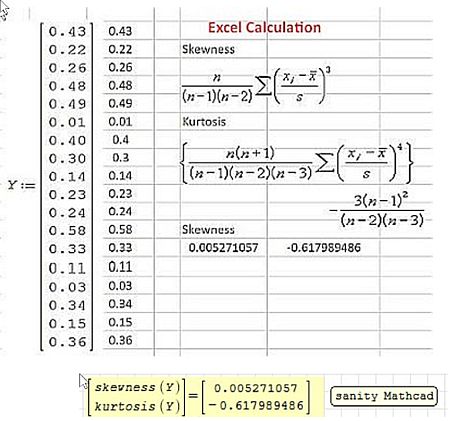

Forgot to attach the Excel worksheet. Sorry!

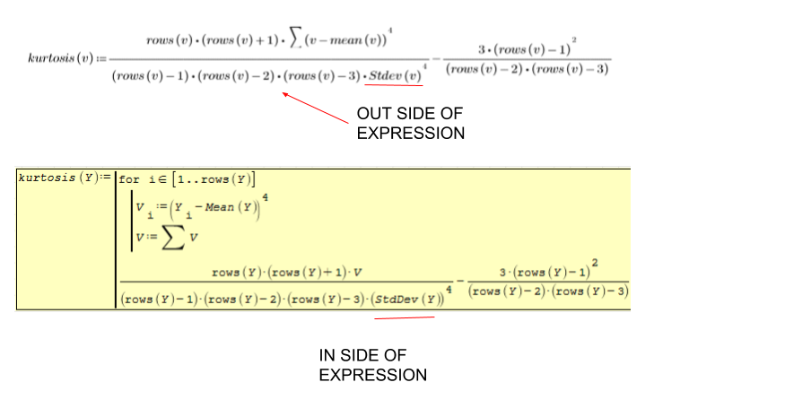

Source code: Mathcad/Mathsoft "Statistical Electronic Book"
I may have found the issue. Not sure if there is a typo or not in your book, but if you look at the Mathcad Website here: https://help.ptc.com/mathcad/en/index.html#page/PTC_Mathcad_Help/example_kurt_and_skew.html
You will see a formula similar to yours. However, you need to move the StdDev(Y) function outside of the left most expression in each function. I'm not at a computer with Smath right now so I can't verify if it produces the same results. Will check back later.

Yes. but (a*b*c)^4 is much different than (a*b )*C^4 Edit: Whoops I see that it looks right in original file. I miscounted parentheses.

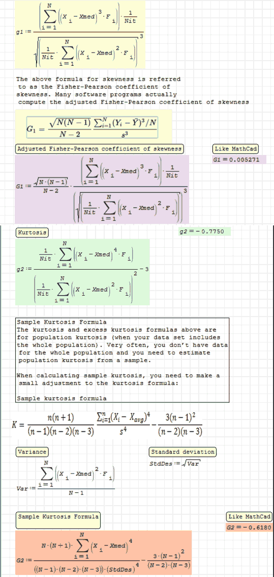

I've done quite a bit of research into this because I've been curious. There are two differences between the Matlab/Smath and Mathcad Functions.
1.) The Matlab kurtosis link mentions this, but the Wolfram link explains it very well. Kurtosis has been historically defined such that a normal distribution has kurtosis of 3. However, Kurtosis Excess is defined with a -3 offset such that a Normal distribution has a Kurtosis Excess of 0. The Mathcad Kurtosis function is really a Kurtosis Excess function such that a normal distribution has a kurtosis of 0.
2.) The second difference is that the Mathcad algorithm accounts for sample size whereas the Matlab/SMath algorithm does not. I found a website here that explains the difference.

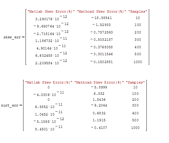

Lastly, I performed a small experiment by creating a Matlab based skewness and kurtosis function as well as a mathcad based skewness and kurtosis function. I then created random vectors with increasing sample sizes (from 10 to 1000) and compared the % error from the built in Smath Skewness and Kurtosis functions. As you can see the as the sample size increases the difference between the Matlab and Mathcad algorithms decreases (at least for Skewness). It may take a minute or two to run.

Thank you both: Alyles, Carlos.
I reconciliated myself with these two descriptive statistic parameters.

Thanks Carlos for your reconciliation ... no more bug !
