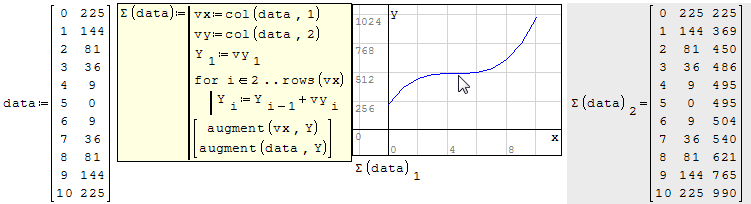

In the attachment at the start of Page.5 I (so far) am unable to construct a loop or something that cumulatively adds vector elements down the column. So I am manually doing this for now, any ideas?
I have started additions from the 6th element because first x4 were zero ...but I think you get the idea!

cumsum.sm (3.95 KiB)已下载 1138 次。

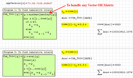

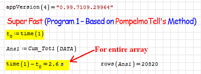

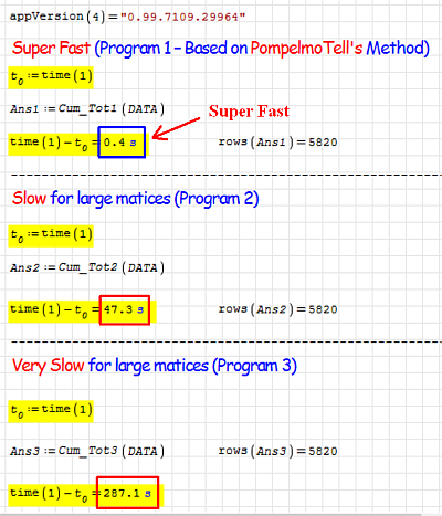

I tested 3 programs to find the cumulative totals of a large array of 20820 elements.
The method of Sergio was incredibly fast, while other two methods were much slower.
Thanks Sergio.

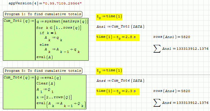

#18 已发布: 2019/8/9 11:33:32
NDTM Amarasekera
NDTM Amarasekera
130个赞,共352个帖子。
Hello Alvaro
I get following result in my laptop.
Yours is a very good alternative.
Thanks.
