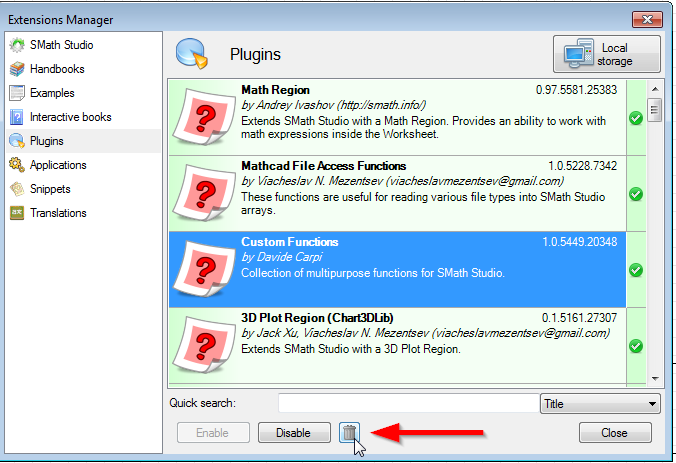

#2 Posted: 2015/7/28 10:41:30
1,441 likes in 2,932 posts.
Seems you have some outdated plugins.
Go to Tools > Plugins and try to uninstall every custom plugin.
If this option is not available in your SMath Studio:
  • Close your SMath Studio
  • copy & paste %APPDATA%\SMath\extensions\plugins in the search field of your start menu and press enter
  • delete eveything in that folder
  • open SMath and download again the plugins you need

Sorry, but I tried to find the solution yesterday and today, when I found the answer you've already answered ...
This is the post:
http://en.smath.info/forum/yaf_postst2752_IF-function-error.aspx#post14902
I did the same you say, delete all documents in the folder and the problem was solved.
Again you save me Davide, you people, are awesome!
