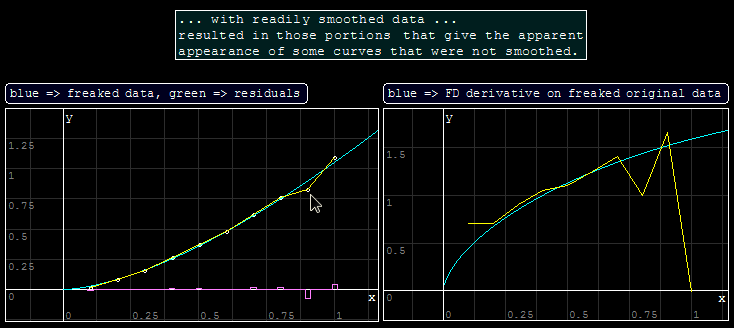

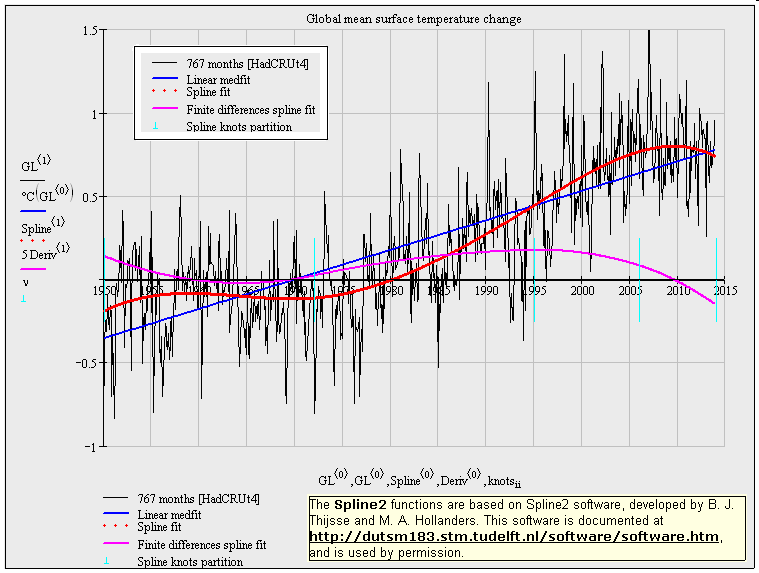

Wroteuntil my age of 62
Oh ! my friend, you are a spring chicken vs Jean.
Smoothing is a rescue tool when no fitting method
is productive [model global, model piece wise ...].
1000's of data sets got well done Mathsoft Collaboratory.
I'm just addict to data.
Cheers, all the best.
Best regards Jean Giraud.
