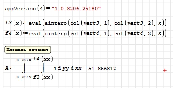

The type errors your version reports is
wrt some limit(s) of the double integration.
Why specific to this version ?

... code that test double integration in your latest SS.
Hoping more Collab will code as well to sanity.
