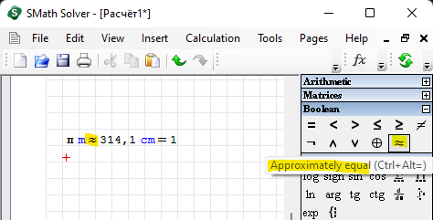

Approximately equal operator is available now (see Options dialog to set the accuracy):

I see the "Approximately equal" operator accuracy varies from 0 to 15. What does this value actually represent?
#4 已发布: 2022/6/20 18:51:54
2,344个赞,共4,057个帖子。
组: Super Administrator
Hi! It is an accuracy of the "Approximately equal" operator. F.e. if the accuracy is 0, then pi≈3, if 1, then pi≈3.1, if accuracy is set as 2, then pi≈3.14 etc.

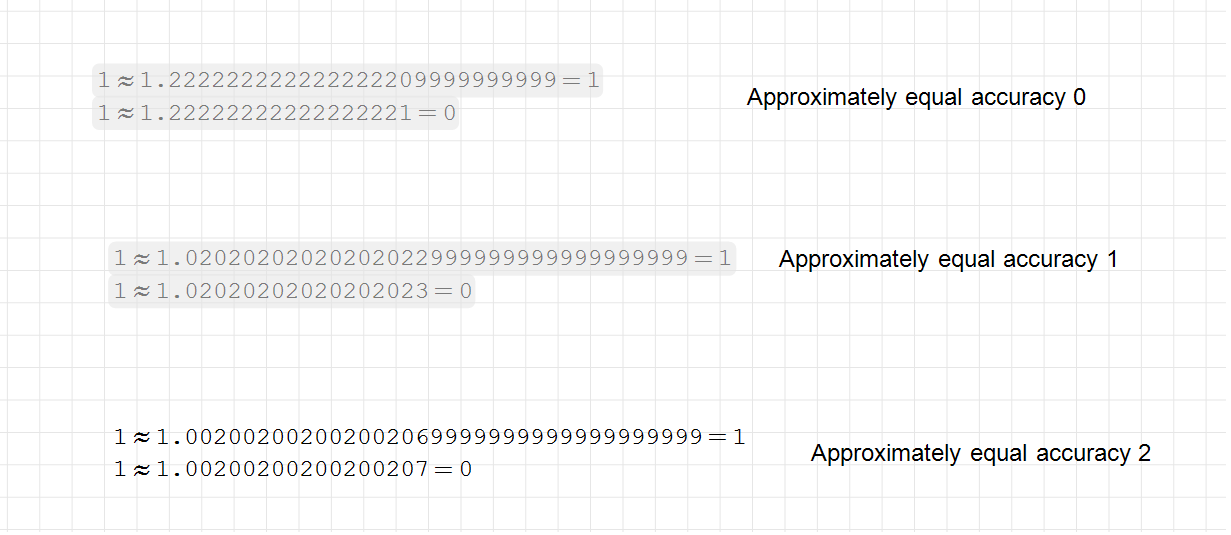

It's more than just the decimal place precision.
approximately.sm (4.89 KiB)已下载 1669 次。

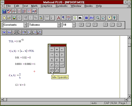

Hi. About the new approximately equal operator, another way to introduce it could be introducing a general infix operator, like in Mathcad. This screen capture is from Mathcad 6 running in Windows 3.11:
For work with units you just need to modify the rhs by abs( a-b ) < UnitsOf( a-b )*TOL (or maybe UoM). Notice that also can be a solution for another features requests, like this one about inline division: https://en.smath.com/forum/yaf_postst21614_Inline-division.aspx

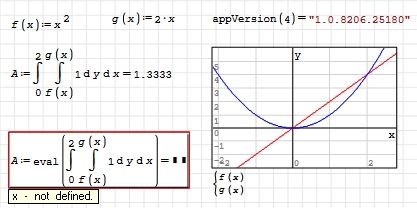

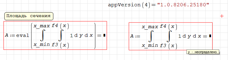

Перестали вычисляться безразмерные интегралы

Thank you. But the problem is not because of eval(). She's somewhere deeper. My f3(x) and f4(x) limits are ainterp() of the table data.
#15 已发布: 2022/7/4 17:22:02
1,139个赞,共1,805个帖子。
Hi. Yes, I see that there are more than one issue with the double integration, even for some simple cases it is not sowed.

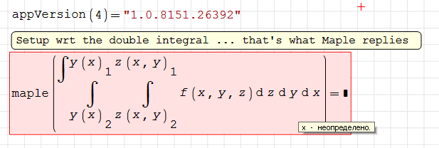

You don't provide enough maths for attempting to doctor.
You may get inspired from the double Simpson integrator.
Please, don't hesitate ... Jean

The question is why in the stable version integrals are calculated without problems, but in the new one it gives an error in the same places ?
In other words, you declare a bug.
Designers need the document for doctoring.
... doctor since which SS version ?
1.0.8151.26932 OK
1.0.8206.25180 NFG
Yes, I'm reporting a bug. In version 1.0.8151.26932, dimensionless integrals with limits in the form of arbitrary functions are calculated correctly. In version 1.0.8206.25180, such integrals are not evaluated. The error "x/y - undefined" is returned.
