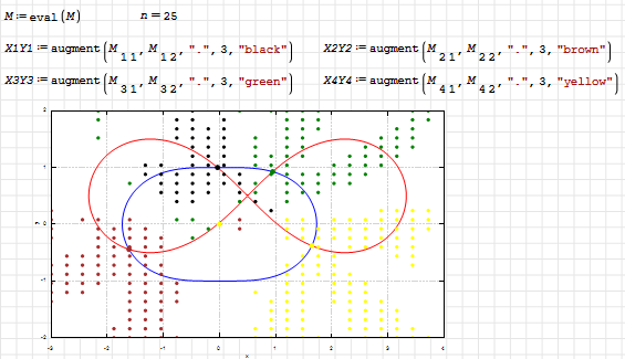

See please the attach
n=10-20 OK, n>20 - I can not get the answer.

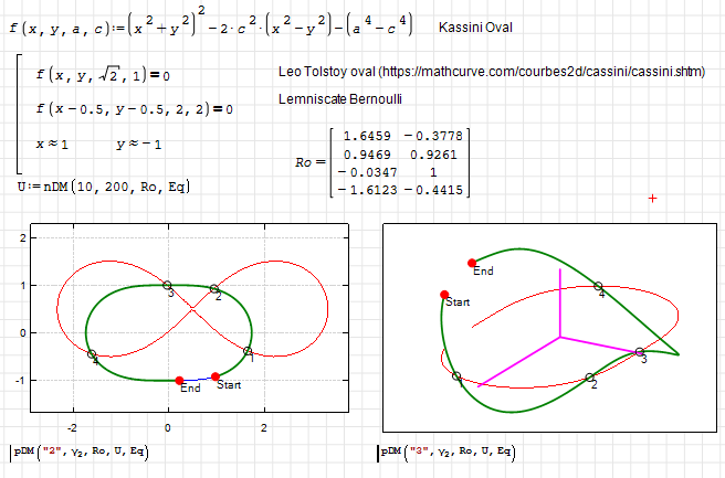

Hi Valery. You need to add an eval for that.
Also can try to use the Draghilev's method and Mathcad block using the library in this post.
DraghilevSolveBlock-Tolstoi.sm (269.54 KiB)已下载 1491 次。
