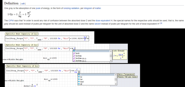

I'm putting together a sheet using the CoolProp wrapper
It generally works really well except for the following
Where I'm getting strange units for the Specific Heat capacity of Air
I've tried overriding the units but still don't get what I want (J/kg/K)
I've attached an extract from the sheet --> UnitsProblem.sm (7.04 KiB) downloaded 1091 time(s).
Probably a really simple answer but I can't seem to find it !!

Can't reproduce either "Units don't match",
because there is NO heat capacity unit in Smath.

Thanks All,
You are all correct (I knew the answer was going to be obvious ) , pasting in the units J/kg K works fine
Its just that Gy/K seems an odd default unit
Thanks for your help
Peter
Peter
