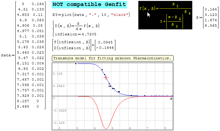

Data set from Art [Mathsoft Collaboratory], unexplained, no abstract.
Bonus in this Smath document: Min/Max Golden ratio.
Seemingly, the fit may be adjusted so that the min derivative be
exact wrt the reference start point [3, 0.164] ... not offered.
... => here is !
