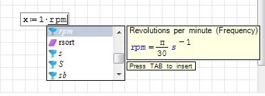

I am new using sMath Studio so this is likely to be something I am doing wrong but I haven't been able to make sense out of it so I'll just report it.
rpm is defined as pi/30 (1/s) . That is what it shows when I hover over a variable defined with that unit.
However, according to wikipedia and my common sense, rpm = 1/60 (1/s or Hz) = 2*pi/60 (rad/s) = pi/30 (rad/s)
That means that every time I use rpm the result is off by 2*pi which is quite annoying.

184 likes in 434 posts.
SMath defines rpm as 2*pi/(60 s), where 2pi is whole angle in radians, 60s = 1 minute => the dimensions are rad/s

but, that is not how sMath Studio treats it. Because according to sMath Studio: 1 rpm = (2*pi/60) Hz!!! (not rad/sec)
I know radians are unitless, but that doesn't mean that you can say rad/sec = Hz, because Hz = 1/sec, if you want to get to rad/sec you need the 2*pi factor.
An example:
I write in sMath Studio: x:=1000 rpm
then I ask it to write it in Hz, and it comes back with x = 104.7198 Hz, which I think is not right, the answer should be 1000/60= 16.6667 Hz

I think that the root of the problem is that rpm is not an SI unit. Therefore you can consider it to be either a unit of frequency (of rotation) or a unit of angular speed.
If you consider it to be a unit of frequency (angular frequency) then 1 rpm = 1/60 Hz follows immediately. If not then you get the 2*pi factor (what sMath Studio does).
I have been looking for some information online and in most of the webpages I found they consider it to be a unit of frequency. Which makes sense to me since frequency is event for unit of time and rpm is revolution (event) for unit of time (minute).
By the way, even sMath Studio (once you hover over the unit) displays it as a frequency (not angular velocity).

#16 Posted: 2016/9/9 09:24:11
1,353 likes in 2,264 posts.
Good point indeed. This should be changed. It also applies to some other units. This can be seen best in the insert unit dialog. There, some categories are missing:
angular velocity
angle
The angular units currently are categorized as dimensionless.
Filed as SS 2395
