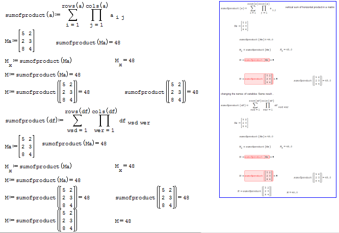

Hello, there is a simple turnaround so it's not a big deal, but still... This looks like a bug...
Or is there something I didn't understand?

It's not really a bug but a smath behavior. If you add an "eval" that forces the numerical evaluation of the nested producer, it works

I'd still call it a bug. Is there any good reason why definition and display in separate cells behave differently from definition and display in the same cell?
There is no problem with def and display in different cells with the original definition (without eval). You also can use M:eval(sumofproduct(Ma))=

Augmented version ... no red SS 6179
If you don't see or have red the 3 blocks,
please let me know for a snippet image.
